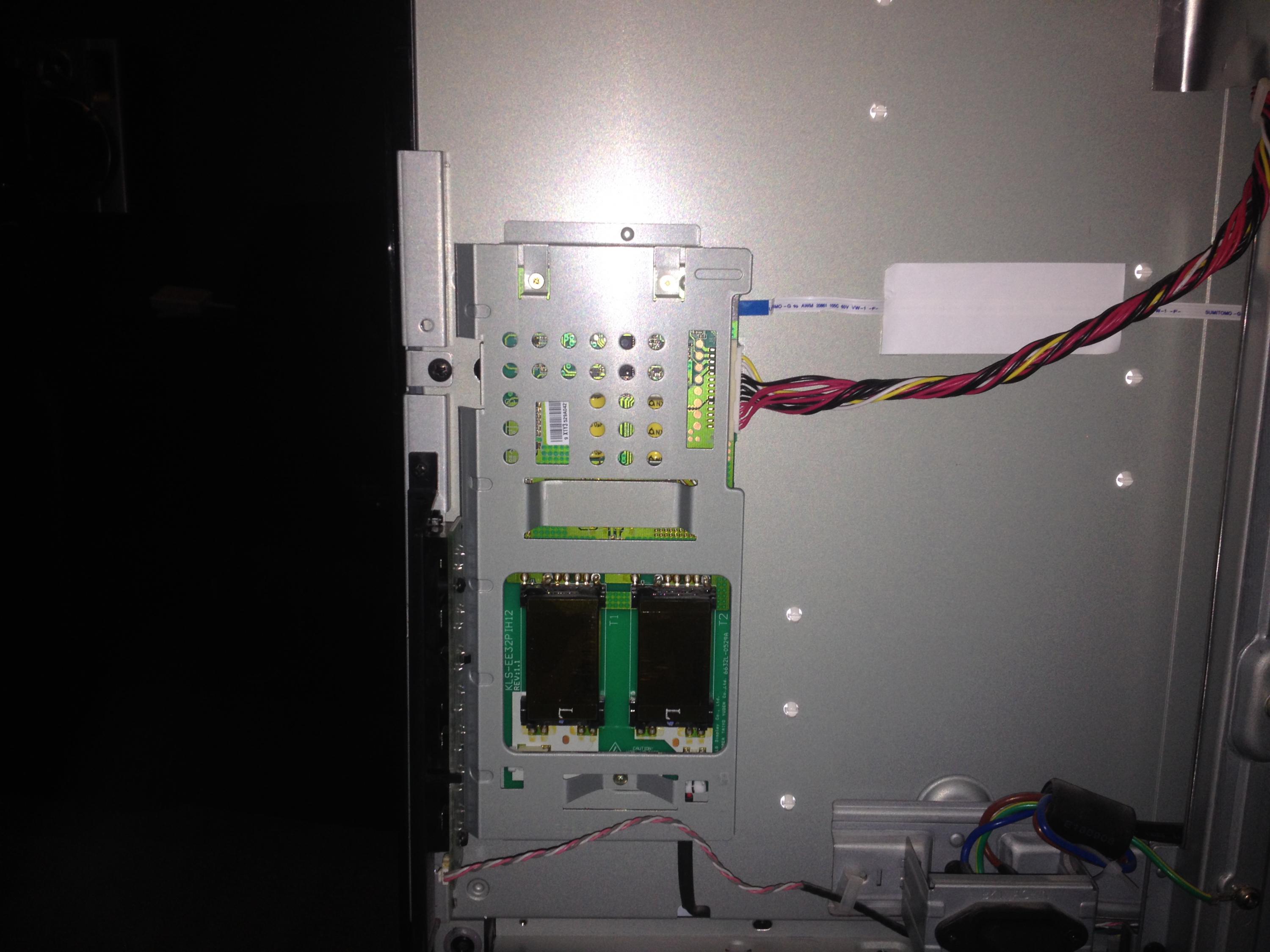

      I think ive put it down to the logic board, I disconnected the inverter board and got the dark picture where i could very faintly see white items from the menu screen and the image i could see still dipped and got brighter every 3 seconds.
      Is there a comon fault on the logic board LC320WXN-SBA1 ?
      There is a small ribbon cable that goes to the inverter board from the logic board and the tv works the same when this is disconnected, and ive seen the same logic board on flea-bay without the connector for it, does it serve any real purpose?

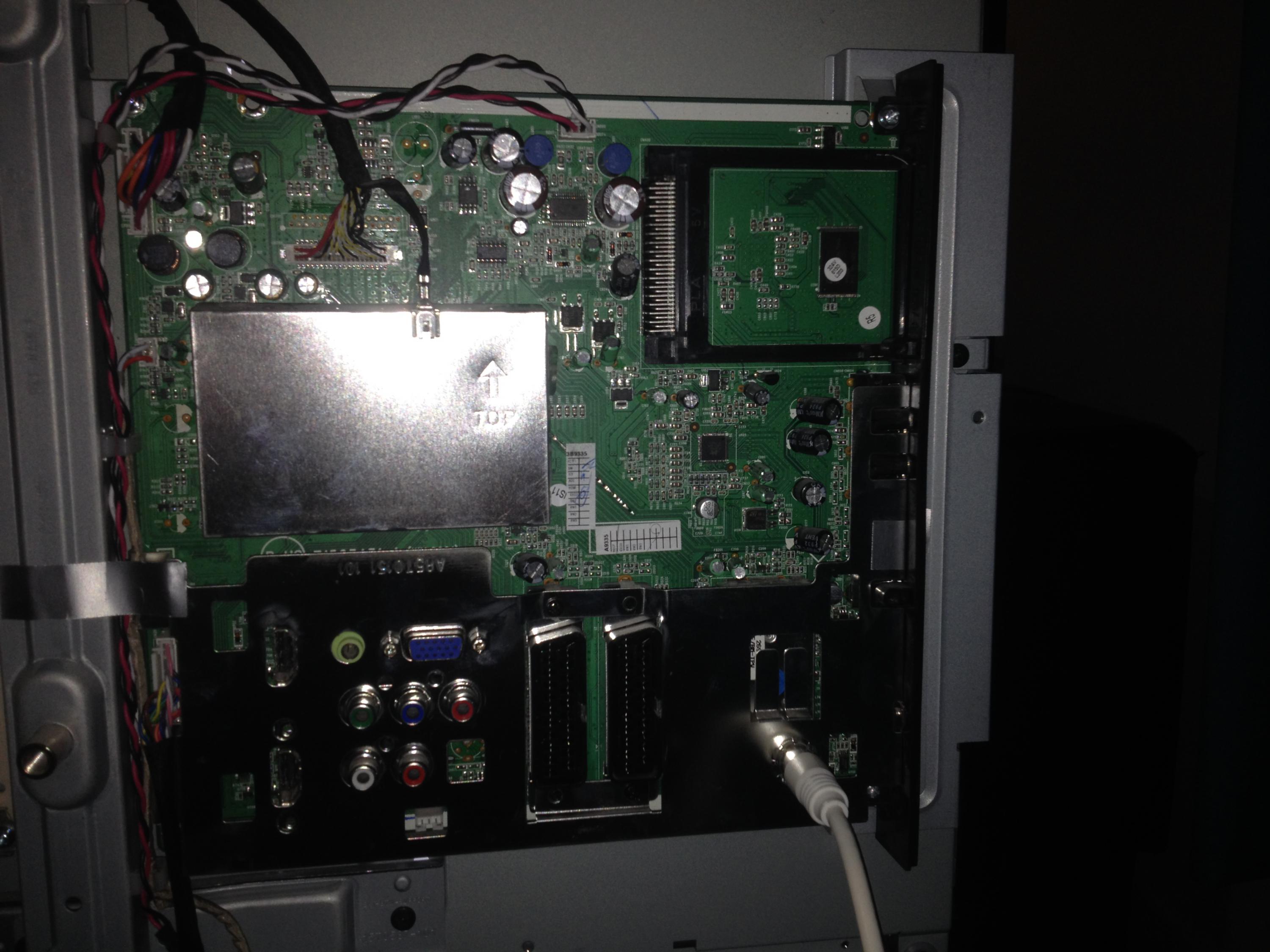

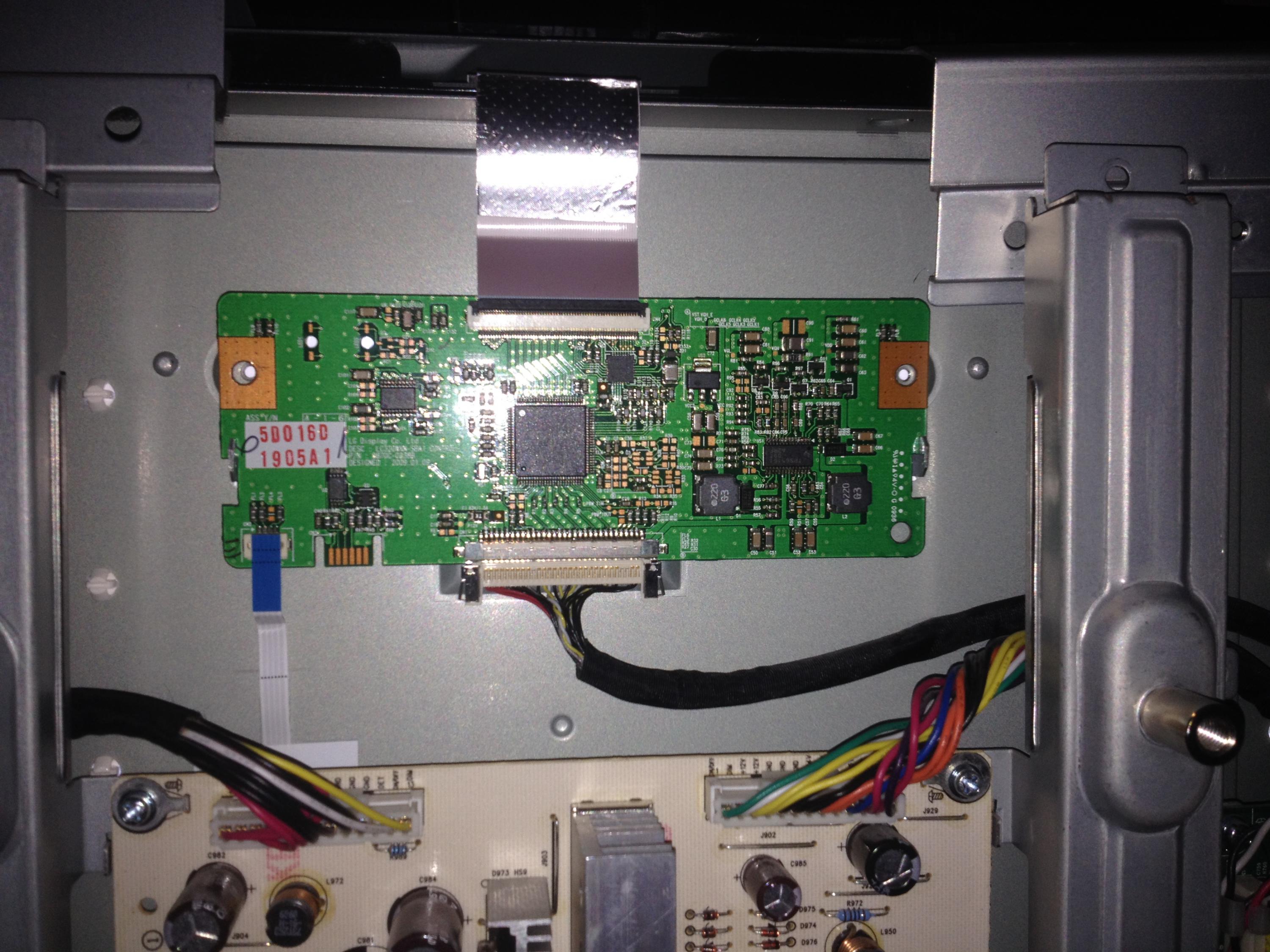

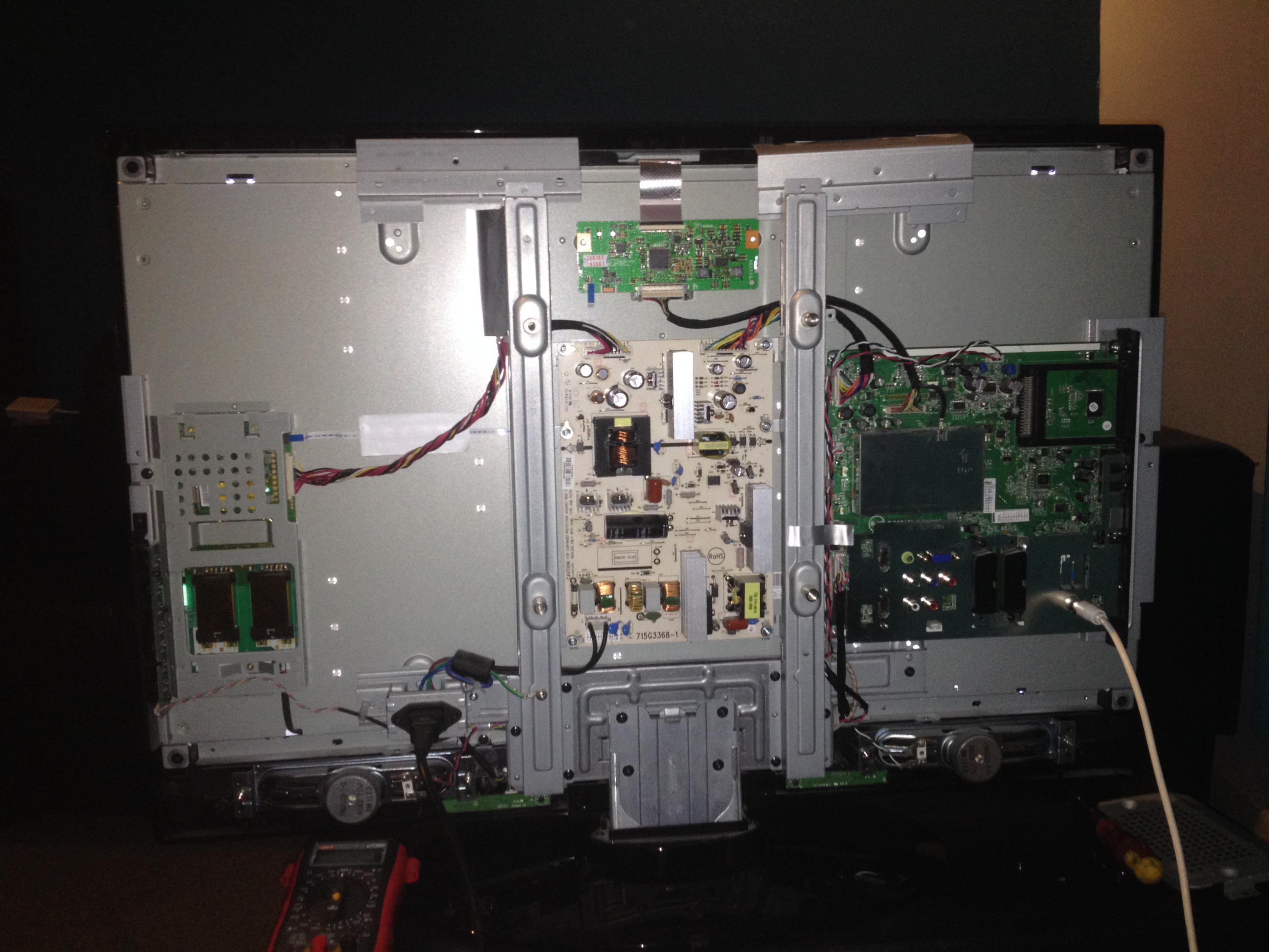

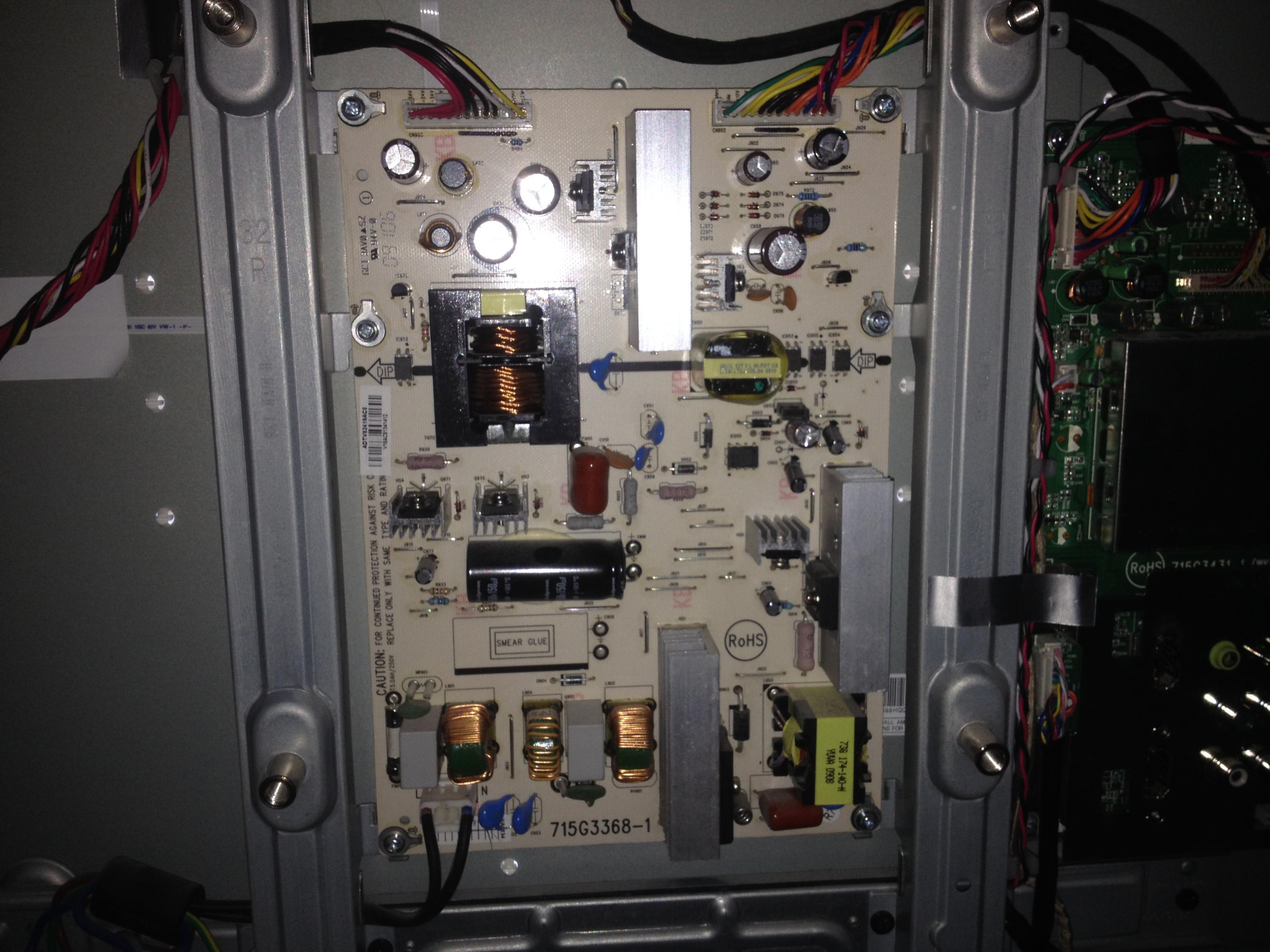

        Some photos of the internals

          Ive now replaced the tcon board and the dimming and brightening still continues.
          The ripple effect ive seen faintly in the background is still there too

          I have checked all the voltages coming from the power board and all 24v rails are 24.3v all 12 volt rails are 12.1v and all 5 volt are there abouts the same.

            Checked BL DIM signal from main board to inverter board? What's that doing? It's an analog voltage from 0V to 3V, typically.
              Re: Toshiba Regza 32AV615DB Flashing Screen sort of
              Its sticking at around 3.42v

                    On the new t.con does the red number match the old one (1905A) this is the part number not the LC320WXN-SBA1 this is the board patten number you need to match red part number and the small ribbon going to the inverter is meant to dim the inverter you can run it without this connected to see if it helps Flocko

                        Floko the t.con 1905A1 matches yes. Everything mataches, ive tried without the inverter ribbon cable to no difference too.
                        The3_uN1Qu3 Thing is if i reconnect the old t.con the fuzzy erratic distortion stops happening , its only started happening after the new t.con

                          It could be ripple in the power supply but not likely. If you have a scope, that's the best way to detect it. You can set your multimeter to SC and test as well ( set it for the lowest setting.

                                  Right well, considering ive tested the t.con and the 3 second dim then brighten still happens, ive checked the inverter again by removing it and turning the tv on, with a black screen and the sound still there, ive pressed menu on remote and got a solid white icons from the top of the menu, then with a Led torch pressed against the screen close to the white icon i can see the icon dimming and brightening every 3 seconds still.
                                  So it has to be either the screen or the mainboard right?
