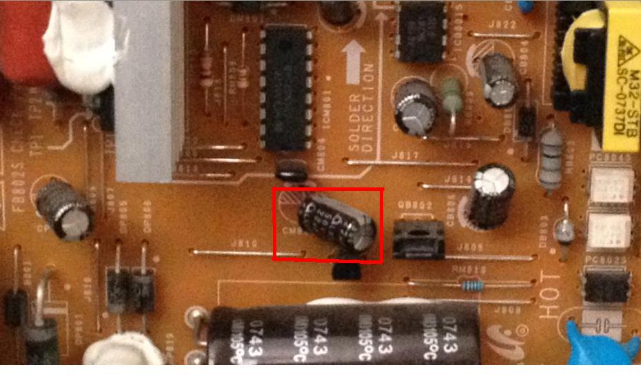

    Check the 24V for the inverter connectors, the readings are rather odd.

        Re: Samsung LE32M87BD - stuck in standby - blinking LED
        Originally posted by tom66
        Is it me or is one of those capacitors on the power supply slightly bulging?
        Sorry to labour this but Tom did you mean the one just above the BIG cap.
        It looks odd to me - the cover looks wrong and tipped so could be pushing the bottom?
        Its also a 50v so could be the startup cap which might cause this?
          can you lable my photo then i will take you a close up picture of it

                    #29
                    yup.

                      #30
                      Ok progress
                      I replaced the cap suggested by selldoor - no change
                      I then tried resetting the eprom - no change
                      I then tried the hair dryer on the top left shield as suggested by anotherdude - success the tv now comes on and it works fine
                      Now i know its the main board problem but how do i permanently fix it as when it cools down again it dosnt come back on ?
