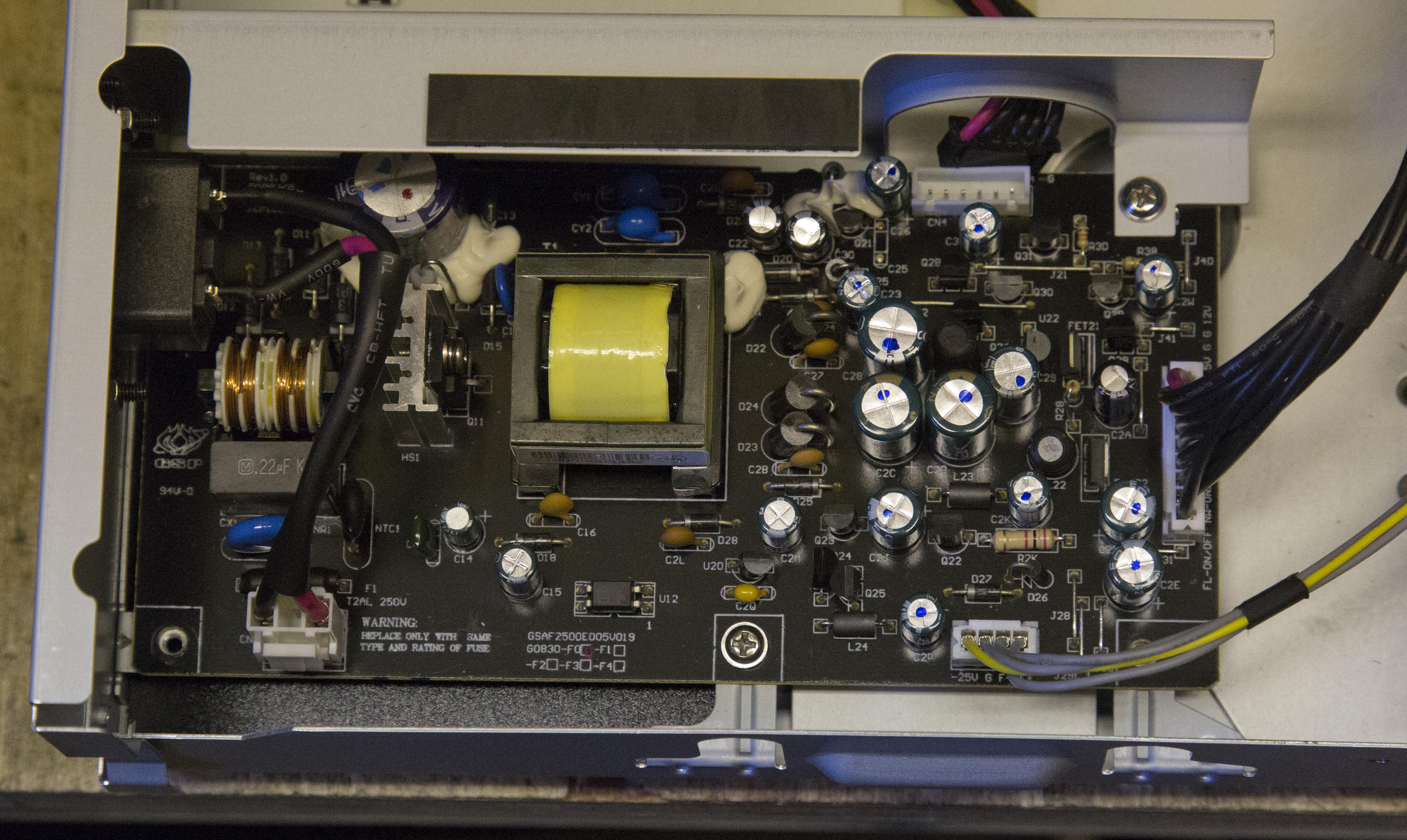

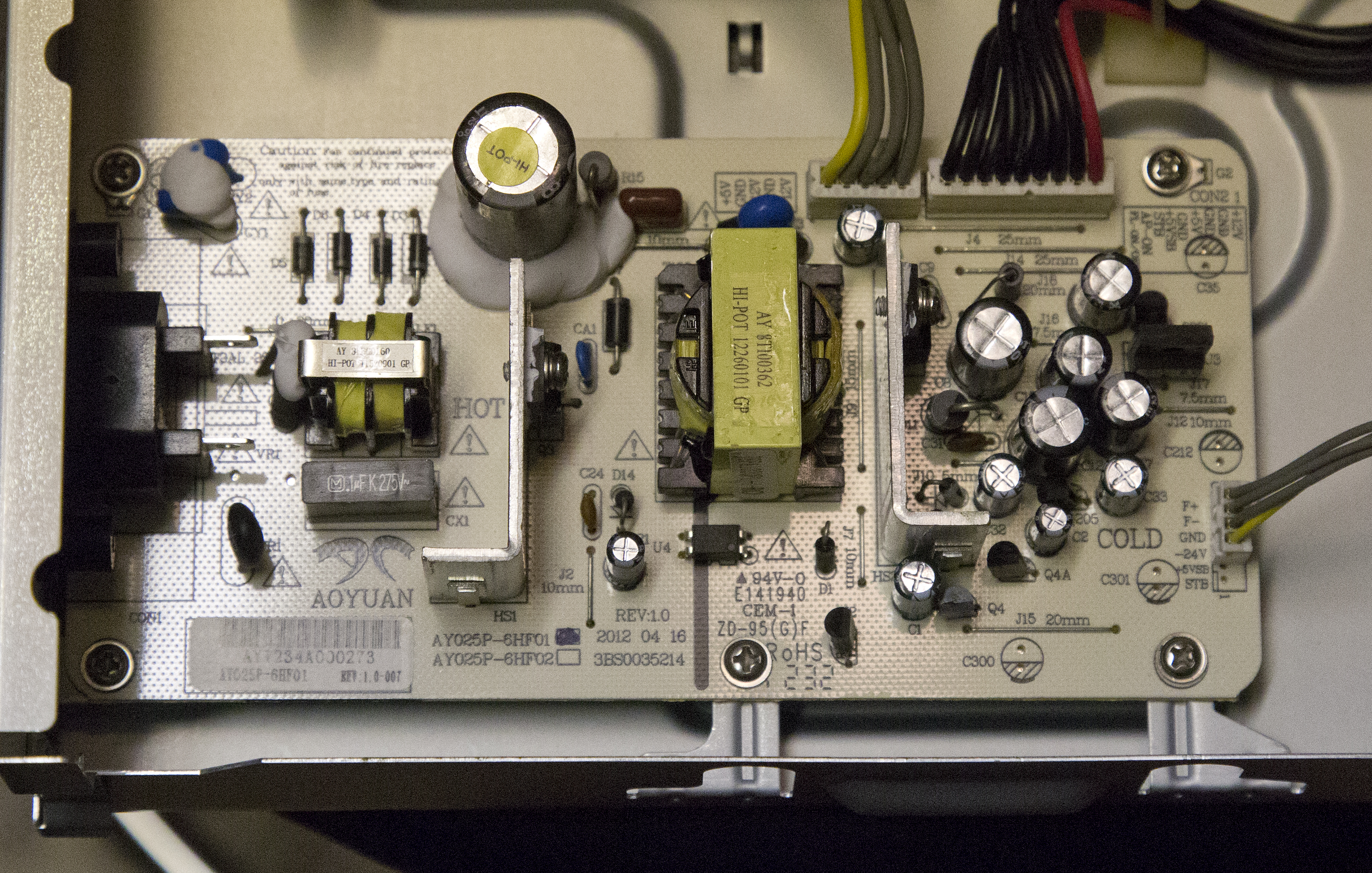

                                    • Xenon-Codex
                                      • 186
                                      • Finland
                                      Dark one is the dead board from the A1060, white is the working from the A1020.
                                      • nomoresonys
                                        • Jan 2013
                                        • 12323
                                        • U.S.
                                        Try something simple, sometimes heating the electrolytic caps will bring a marginal/bad cap back into specs and the device will work if only for a bit. Heat all the electrolytic caps with a hairdryer for a couple minutes and try the player, don't wait til it cools off, try to work it while they're still hot. Check the solder joints on the bottom, make sure none are bad, search for images of bad joints if needed.
