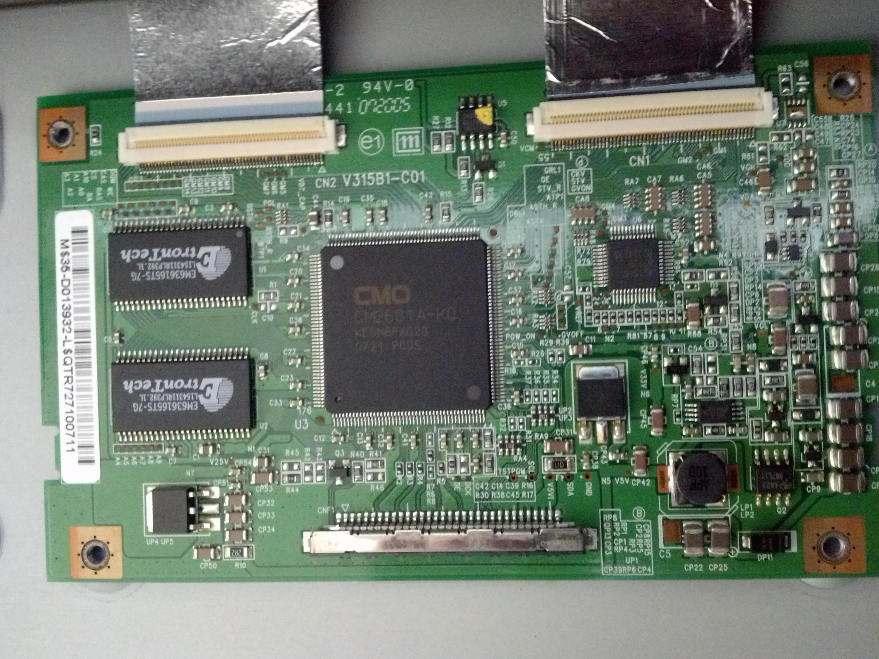

      The AS15 IC is the small IC, it does looks like GAMMA voltages issue. Post good clear pictures of the T-CON board so we can give you the voltage test points to test.

        Re: Polaroid 3211-TLXB Cap Issue
        thanks for the response here is the TCon with the main board unhooked
          Yep, it does use AS15 Gamma IC U6.
          See those test points (by CN2 connector) which are labeled as GMx. Report the dc Voltage readings in sequence
          I.E.
          GM1:
          GM2:
          ans so on.
            Gm1 13.6
            Gm2 13.6
            Gm3 13.6
            Gm4 13.6
            Gm5 13.6
            Gm6 13.6
            Gm7 13.6
            Gm8 2.4
            Gm9 7.2
            Gm10 11.1
            Gm11 9.8
            Gm12 8.5
            Gm13 6.6
            Gm14 0 VDC
            I also noticed the power supply is making some noise...not too loud but audible when I was taking the readings. Not sure if this is an issue because I know power supplies sometimes make noise. I'm all ears for the next step!
            EDIT: I used the ground point on the TCon for readings and grounded the chassis that holds powersupply and mainboard to where it's supposed to be screwed down
              That is bad, need new T-CON board or replace the IC.
                FYI if plotted on a graph a functioning ic will produce a curve headed in one direction. Yours has three glaring faults: same reported voltage GM1->GM7, rising voltage GM8->GM9 and precipitous drop from GM13->GM14 (as well as GM7->GM8).
