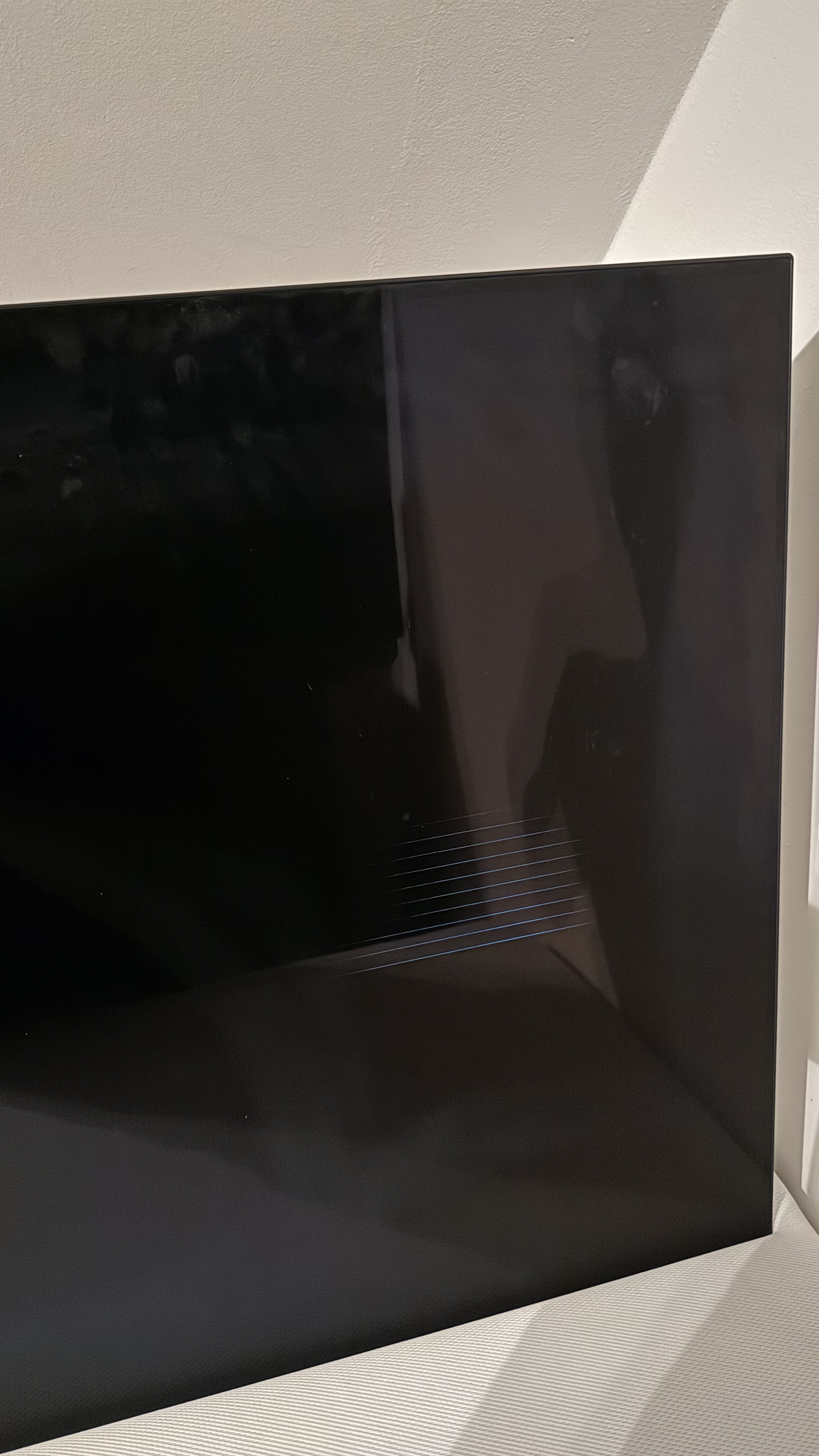

    I recently picked up an LG C1 in 65 inch size. Previous owner told me that the TV won‘t start, so I did believe due to PSU issue, but not this time. I could narrow it down to the T-Con or Panel.
    PSU and Mainboard work both like intended, all Voltages available, Optical on when T-Con lower Ribbon is disconnected and I even managed to get some picture with P-Only, IN-STOP cycle but only for 2 sec. before shutdown.

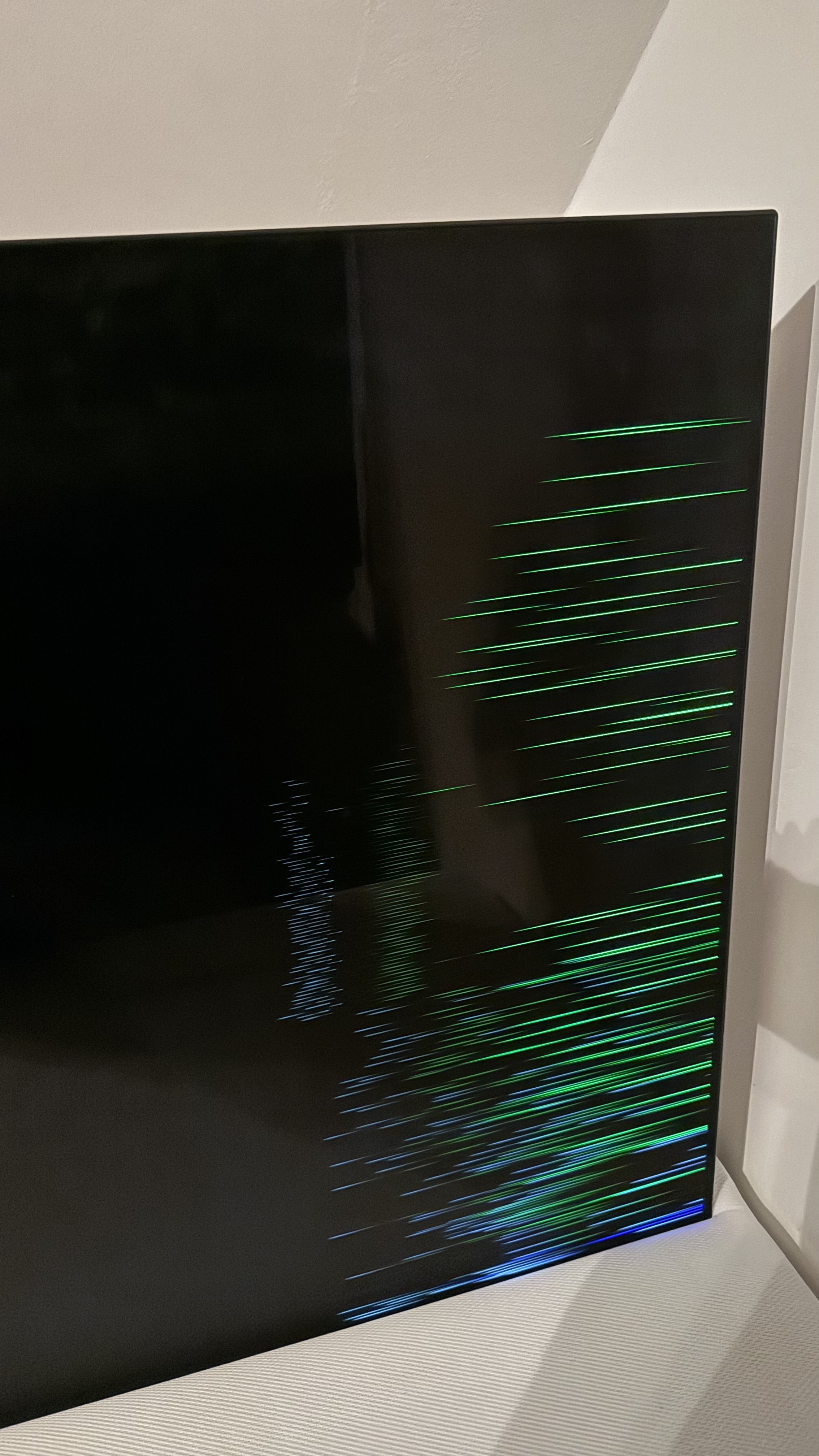

    For the stand alone test the panel starts with some flashing horizontal white lines and then continues to build up some color on the left side of the panel with increasing in brightness and variation over a time of 5-10 minutes. See the attached pictures.
    I‘m now stuck in further investigation on how to determine if it‘s and Panel or T-Con issue. Btw all fuses at T-Con are continuous.

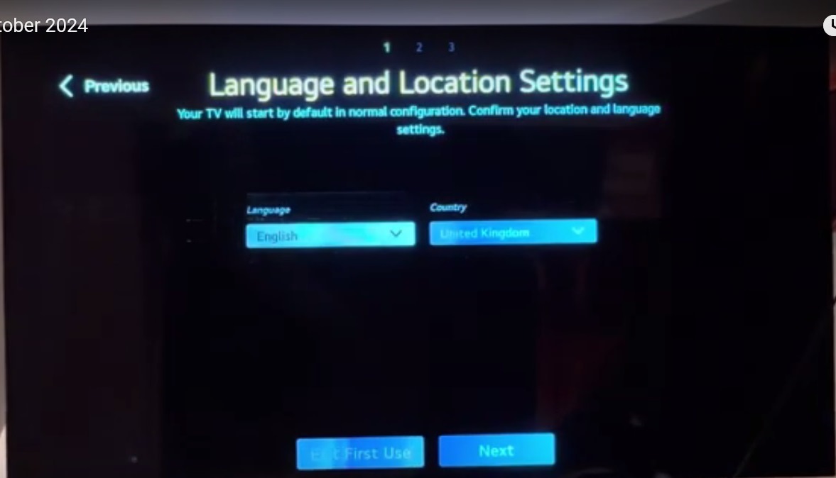

    you need to exit power_only first ...disconnect the EVDD 24V from T-con side... turn on... optic will lit on... give time for it at this state.for 5 minutes,. install camera at the front of the screen if you don't have one help you..... while the TV ON plug back the socket you unplugged before let see what will the screen showing

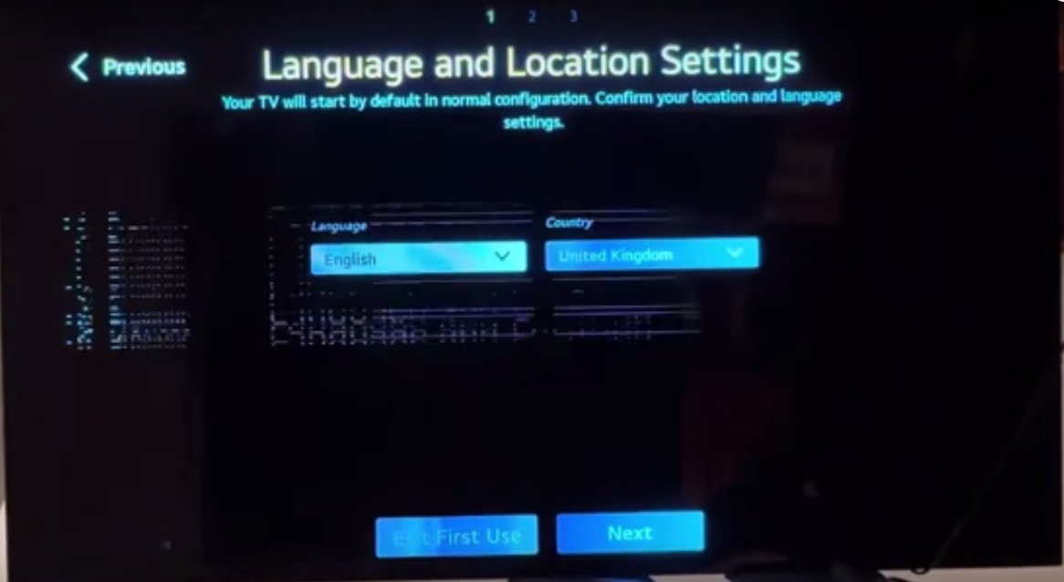

      Only the welcome screen like I‘ve seen before already. With some artifacting lines in the middle. After 1-2 sec. it powers off automatically.
        do it again please before you put back the socket... press Ok on RC to pass the first page so come language page.. so we can see whole screen not only at the middle.
          Alright, I did like you described. Uploaded a short clip on youtube. https://youtu.be/NooYblfm0JQ

            ok. this noise from T-CON or at he buffer boards, i would go to invest with T-CON from same size and model.

                you can compare both if MB work on it then T-CON will too.. for more sure show here the both in high quality photo
                  yours steps when you plug back EVDD socket... it show part on left side blue... then clear image... then horizontal. start1 OLED Cells , start2 and 3 T-con reaction... this why must invist on T-CON first if not then need to cutting the cover metal plate to have access to buffer boards

                    So I tried the T-Con from my working CX and unfortunately it creates a similar error with the artifacting lines in the middle.

                        I swapped all working parts from my CX to C1 and other way around. Exactly the same results. CX working with both sets of Tcon and Mainboard and C1 same lines with the running HW from the CX.
                        now I‘ll to the dirty work
