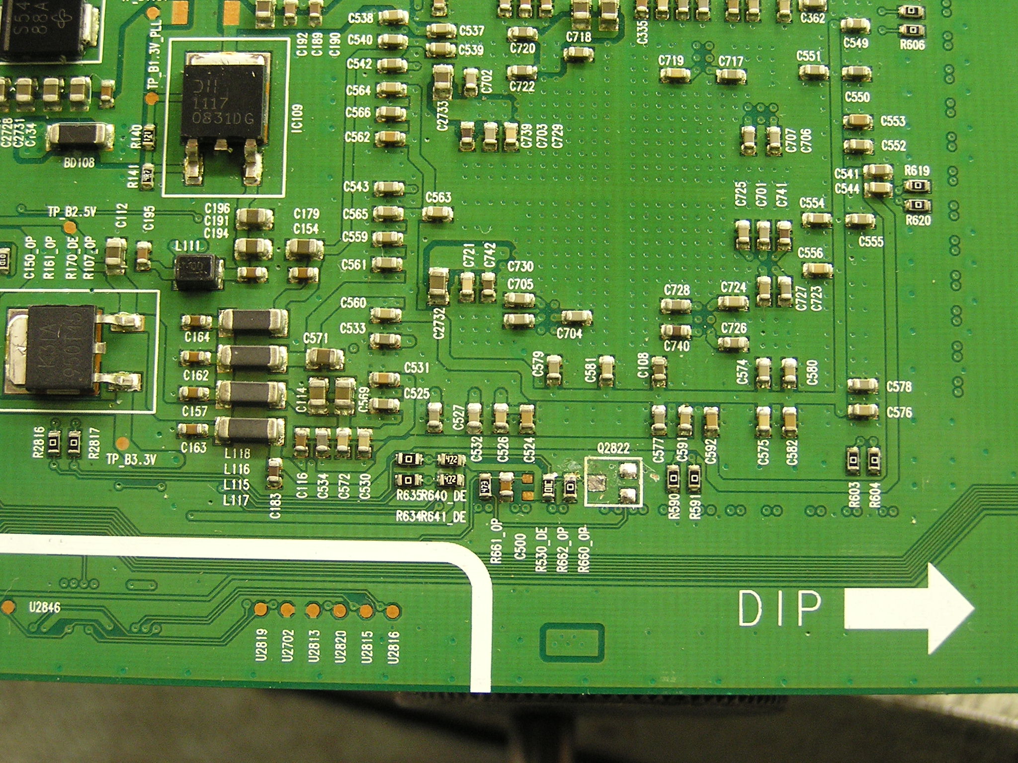

                Hi all, I am working on a Samsung LN46A650A1FXZA 46 inch LCD TV.
                The TV has the same start loop problem as icekillah has. It starts and then shuts off and then repeats & repeats etc. My TCON board is the same as the picture posted by icekillah too.
                Searching this site there are many complaints of bad capacitors. A visual inspection did not show any bulges or leaky ones. I removed the power supply board and checked all the caps for a high ESR. All caps where well within acceptable values. Thus, I did not replace any of them. I then powered the supply separately with nothing else connected using my isolated AC supply. The standby voltage was 5.1 VDC. I then jumped the standby voltage to the On/Off input on the card. The relay clicked and the Run 5.1 and 13.1 came up. The 13.1 was a little high at 13.5 V. I then checked all the supplies for ripple and it was down in the scope leads noise levels.
                I put the power supply back in the TV. The 13.1 and 5,1 came up when I turned on the power using the remote control. It also would turn the set off. The 13.1 was 13.65 and the 5.1 was 5.17 and the backlight came on. After a few seconds, the 13.1 dropped to 12.65V and the looping began.
                I disconnected the Panel from the TCON and the same power start up loop continued. I then disconnect the TCON from the main board and the loop stopped and the set stayed on with the 13.1 at 13.65.
                Since the power loop goes away when you disconnect the TCON, you would imagine that it was bad. But the drop in the 13,1 from 13.65 by over a volt to 12.65 makes the power supply or main board a little suspicious. Although the TCON could be loading the supply.
                Seeing that I am a retired EE and fixing electronics has been a life long hobby, I decided to bug the TCON for obvious discrete component fails. Both fuses are OK, I found that transistor Q2811 was shorted Collector to Emitter, Base to each bugged OK as diodes. Not having a schematic makes it a little tougher. But it looks like Q2811 is a NPN and I have seen bigger ants than it. The emitter appears to be normally connected to ground. I removed Q2811 and the short between the collector and emitter pads remained. Tracing the board it appears the collector is connected to R660_OP and is “0” ohms os marked and to R662_OP which appears to have a diode around it with 5 ohms and 200 ohm readings marked 010. The other end of these resistors go to through holes on the board. The collector pad then continues on the PC board to a through hole by C532 where it gets lost. Attached is a picture of a section of the TCON containing the area I am working on.
                If any of you have a schematic, I would appreciate it if you could tell me if my bugging is correct and where Q2811 collector, R660, & R662 are connected. If the collector goes to the large BG IC with the heat sink, it appears the TCON is toast.
                The other problem I have is the part number of the TCON itself. The two markings are E2347JBI0JC3 – 025059 on the label and FRCM_TCON_Vo.1 on the PC board. The ones I have seen for sale mention a LN94etc. number. There are no other P/N markings on the board. Is this number familiar to anyone.
                Thanks for any help you can give me.

                      Sorry, I have a typo on the transistor ID.
                      It should be Q2822 and R660 making is 0 not 0s
