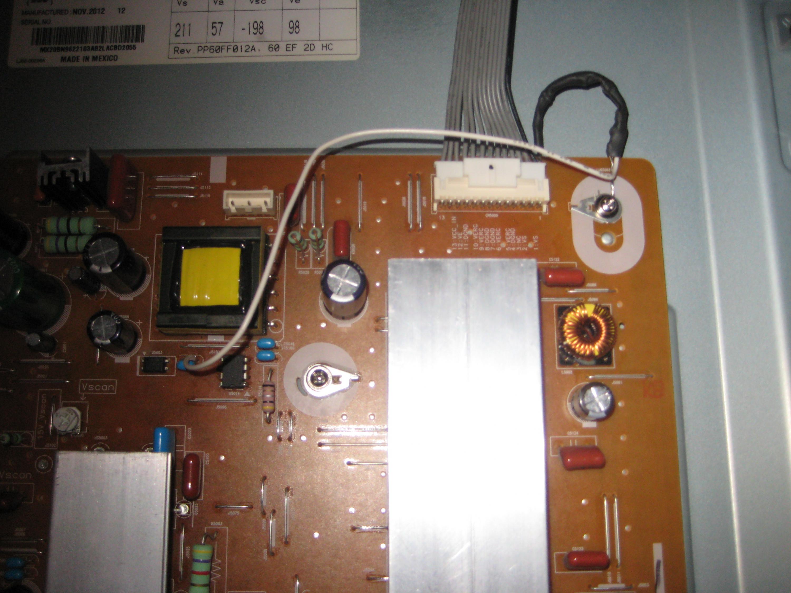

              Ok, so the problem with both of these sets here IS the Infineon 3BR0665J at U5014 right below the transformer for the -Vscan on the Y-Main board.
              Using the datasheet and tracing the circuit, I verified that it is getting power by looking for +15v on pin 7 (VCC, also available on the right leg of C5162 and on the J5101 jumper above it), that the feedback voltage on pin 2 (FB) is up at close to 5v (saying, "Hello, Mr. Chip, we need more voltage", which is the inverse of how I've designed things in the past with a TL494 or SG3526, etc.), that the current sense pin 3 (CS) is not indicating an overload since it's showing no current flowing because it is at 0v drop across the current sense resistor, etc., so all look great, BUT...
              Then we get to the BA, pin 1, which has two purposes. One purpose is to adjust the blanking time for the overload holdback but is not required. The other purpose is to manually put the chip into "Auto-Restart" mode essentially cutting it off and forcing a restart of the cycle from an external source.
              This pin is supposed to be pulled up internally to 0.9v by a current source but shows 0v. The only circuitry connected to this pin in this implementation is a 0.1 uF capacitor to ground to add a little extra blanking time, there is no external circuitry that can be holding it down and, indeed, removing the capacitor made no difference. According to the block diagram, I'm guessing the current source must be defective, the zener diode is shorting or some other internal problem.
              When I spray freeze spray on it, the voltage jumps up to 0.9v and it starts to oscillate, the output of the DRAIN pin looks like normal PWM on the scope and -Vscan comes up properly. Prodding it externally with 0.9v to try to make it come up does not work.
              So, everyone who may have this problem, check the voltage on pin 1 (the lower right pin, indicated by the arrow on the PCB) with your meter's negative lead to ground and if you do NOT see the 0.9v when you power up the set, suspect this part. If you have freeze spray, give the chip a little squirt and you should hear it start to oscillate if the power is on (you'll have to then turn the set off and back on to get the high voltages to come up for a picture) or turn it on if it was off while you sprayed. Both of these ones here come right up and work fine until the next power cycle.

                        Since they wanted all their TVs up and working for football, I did a temporary hack job yesteday to make these sets able turn on until the ICE3BR0665J chips arrive.
                        I made a voltage divider using about 120K ohm (needs to be at least a 0.5 W) from the Vs to a piece of wire and also to about 13K to ground (0.25 W is fine), heat shrinked it up and connected the wire to the VCC of the PWM controller. Check to be sure you don't get more than the 25V maximum rating of the controller chip before you connect it to the chip's VCC at the capacitor, the jumper or the VCC pin itself. It measured just over 20V here but will depend on your Vs voltage and the exact resistors used.
                        This charges up the VCC capacitor to above the 18v turn-on threshold regardless of the flakey precharge supply in the chip and makes the TVs come on first try. Not the best permanent solution but really shouldn't matter either.

                              It seems that the chip is not the problem. Received 2 new chips today.
                              Still had to shoot it with freeze spray to get it to come on. Only showed picture for about 10 min then quit.
                              Is it possible that a resistor or cap has changed value enough to prevent it from working? I have changed all but the large green electrolytic caps.

                                Very strange... I can't see how it could be anything else since there is very little connected to that VCC pin. The photodiode optocoupler is connected to that supply also, I suppose it could be bringing it down somehow.
                                I tried removing the zeners thinking that they might be the problem but that doesn't change anything and interestingly the zener voltage must be above the 30v max of the power supply I was using to test them because they didn't pull it down at 30v input. You'd think the zeners were supposed to be 25v or less to protect the chip, otherwise what on earth are they for if not to prevent an overvoltage to the chip but they still test .7v in the other direction so they're not blown open either.
                                There's really only that and a few capacitors across that VCC and the chip is the one doing the precharge, so I was back to really thinking it would be the chip itself after checking basically everything else connected there but I don't have another of that kind of optocoupler here to try.
                                You could try changing the cap at C5162, it's a 10uf multilayer ceramic but an electrolytic should work, though I tried swapping one with one of the snubbers and it had no effect. SOMETHING is limiting the voltage there and now I really don't know what or why!
                                I'm guessing the fact that it shuts down means you still have another problem with that set. The ones here work completely fine and stay on indefinitely once they are actually started.

                                  Just tried hitting only the new chip w/ freeze spray, set did not come on.
                                  Sprayed optocoupler with a quick burst and set came on. I was careful not to overspray so just the opto got cold.
                                  I am going to check a few psu's I have to see if I can find a suitable replacement opto to try.
                                    #37
                                    Re: Stumped on Samsung PN60E530A3F
                                    Just figured out it is the 106 cap @C5162.
                                    Froze it to turn set on set will run about 6 min then no pic.
                                    Then while set had pic, put flame of lighter to cap and instantly no picture. Refreeze and it comes right back on.
