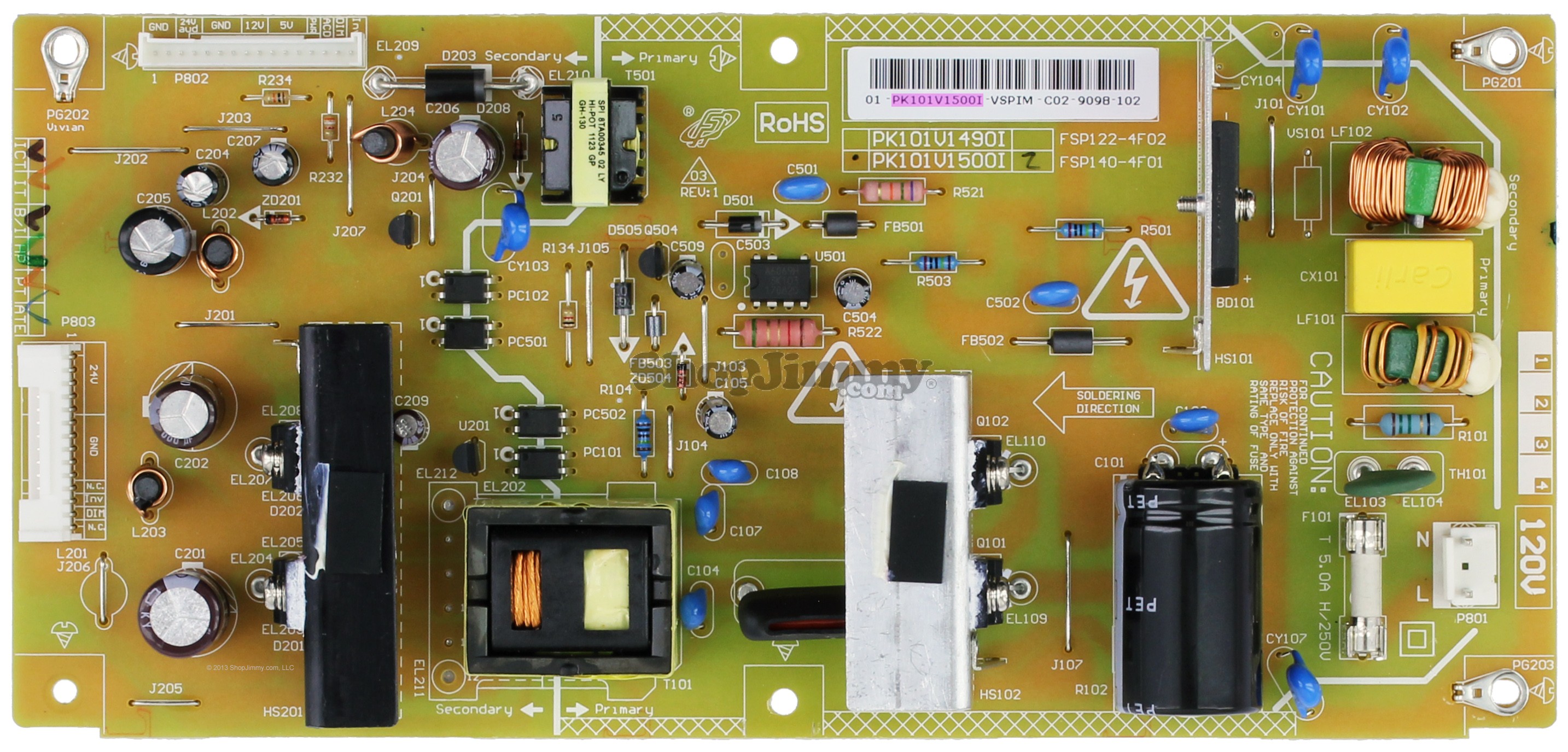

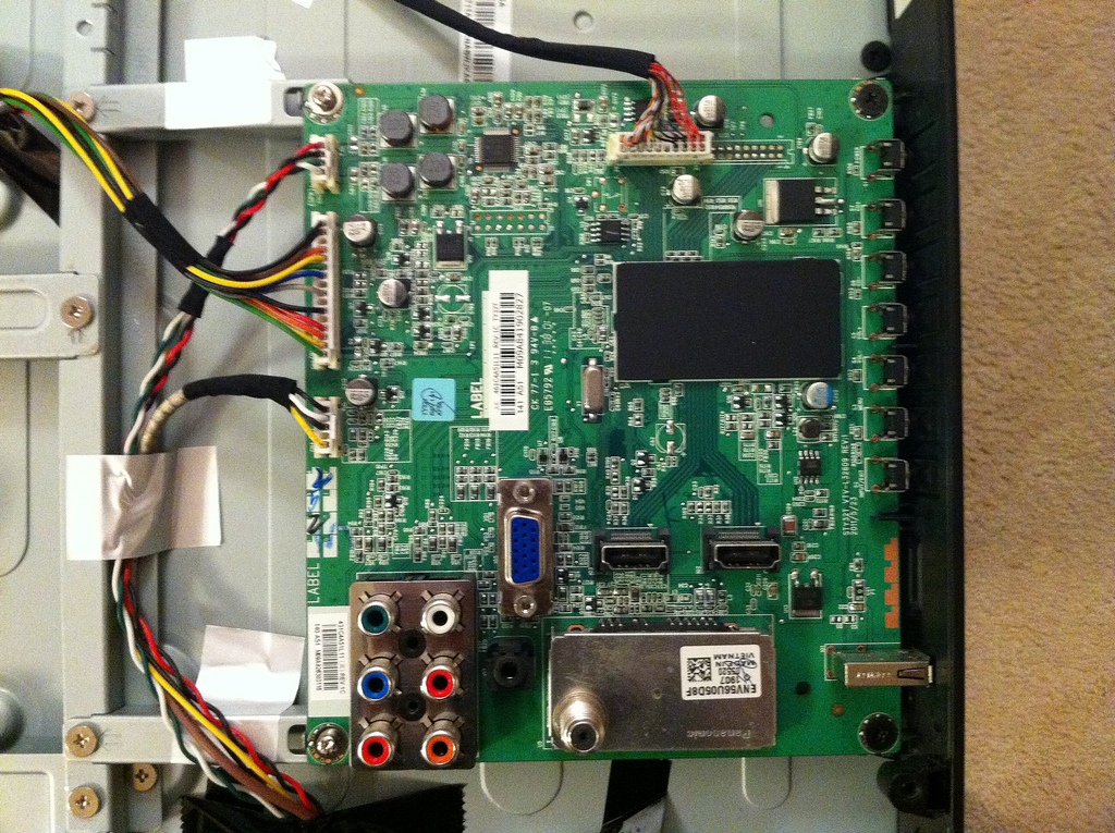

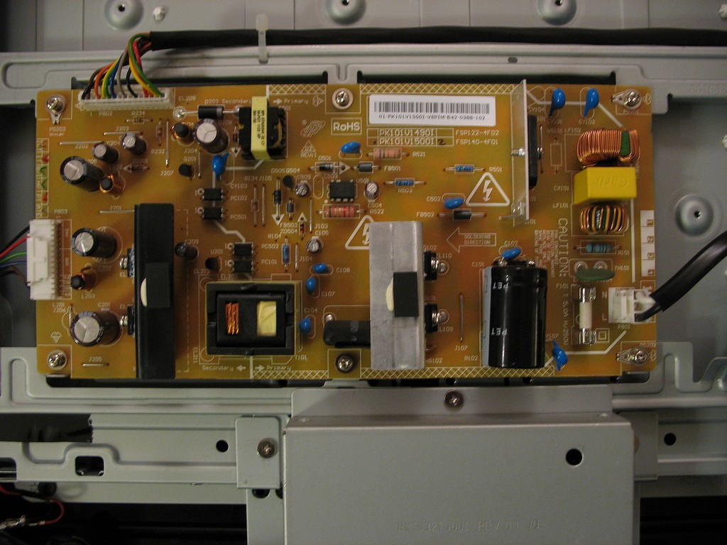

    please post pictures of the boards.
      Re: thosiba 32DT2U1 dead
      http://www.shopjimmy.com/catalogsear...oshiba+32DT2U1
      Are those the correct boards used in your TV?

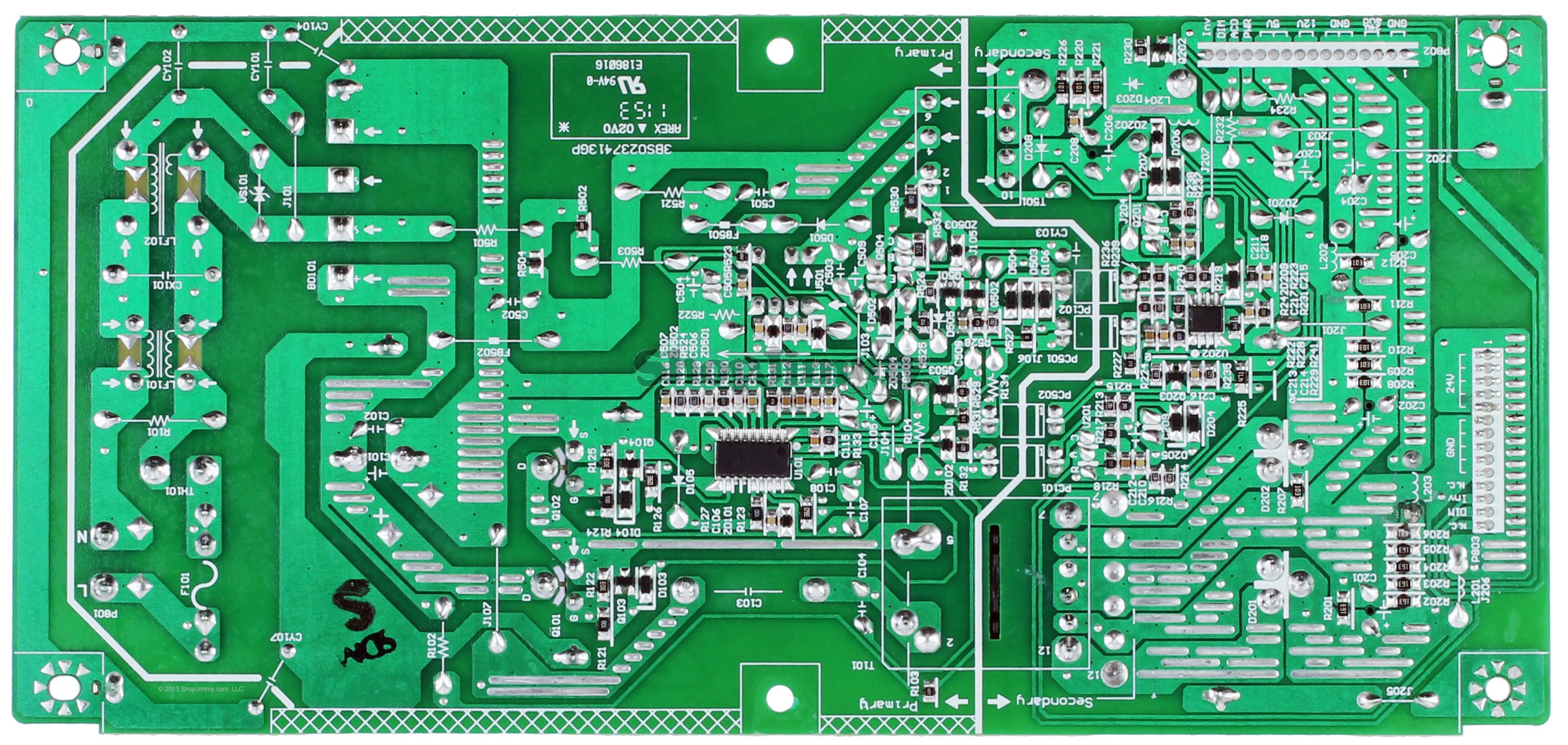

          Pictures provided by shopjimmy.

              This model is known for bad BGA solder connections all over the mainboard. I fixed a few by the "oven" method. 450 for 8 mins. Problem is even though it repaired it the buttons melted. Still functional but not good for resale. I would focus on trying some heat all over the board including the main processor to see if the set comes up. Could use a hairdryer. Keep away from the buttons thou.

                    If you look at the board you can see that Q202 is the one that send this ACD signal.

                        Q202 is close to the connector that goes to the main board:
