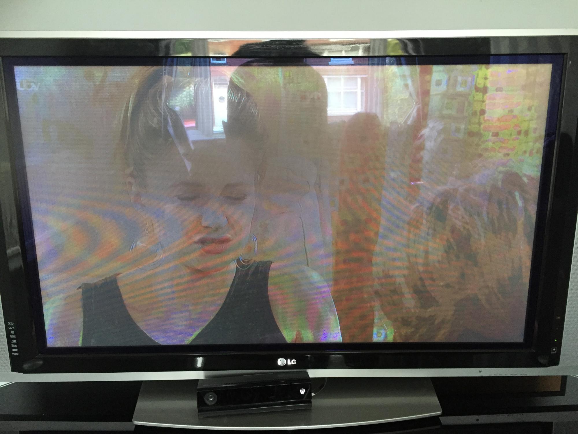

    I have a lg 50px4d the screen goes dark every now and then, you can still see the picture but the quality is also reduced.
    It's been doing it for a while but today it seems to happen every few minutes.
    I will try and attach an image

    Re: LG tv screen goes dark
    Has X-Sustain issues...
    High probability one of the IPM's is intermittent--Common fault.
