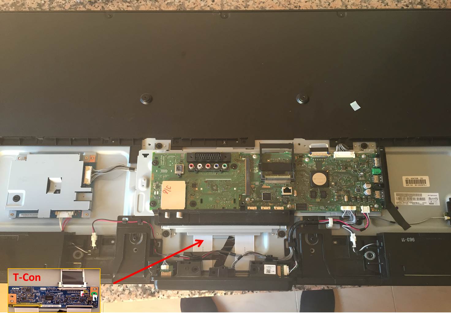

    Pictures of the whole back side of the TV so we can see all the boards?
      Re: Sony KDL 42W705 backlight no sound, no picture

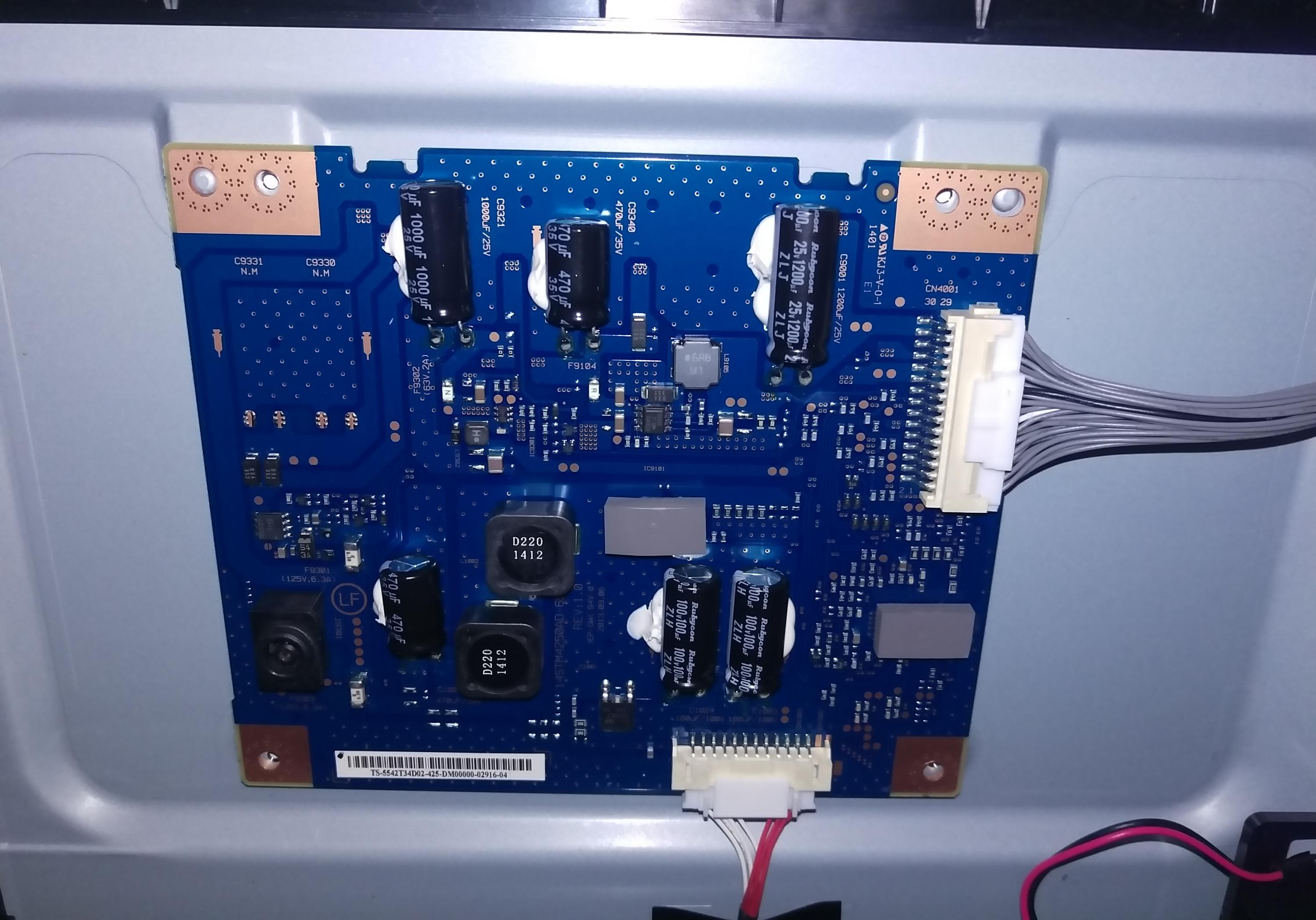

      1st pic Power board with cover taken off

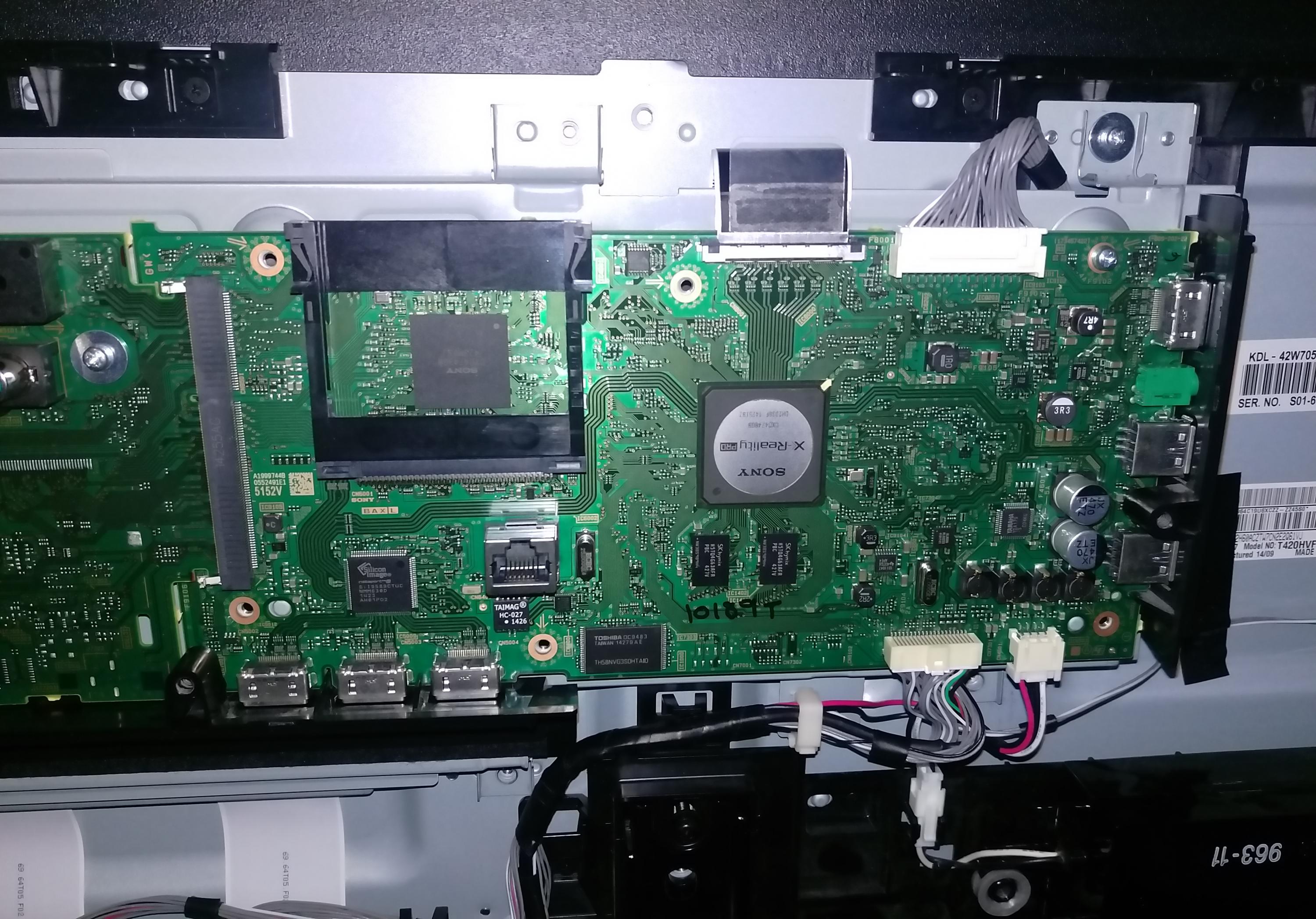

      2nd pic main board

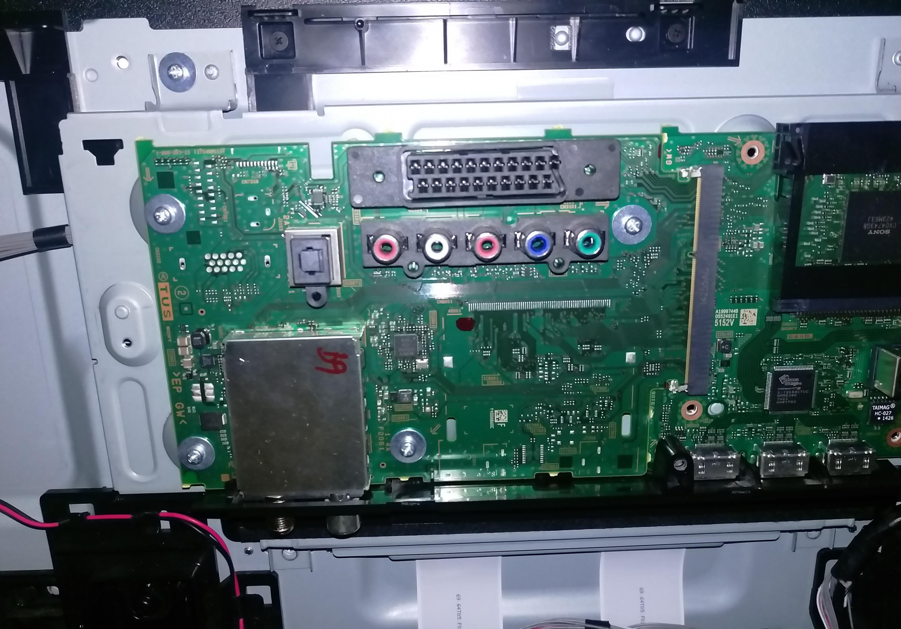

      3rd secondary av board which clips on to main board
      The t con is underneath the secondary av board

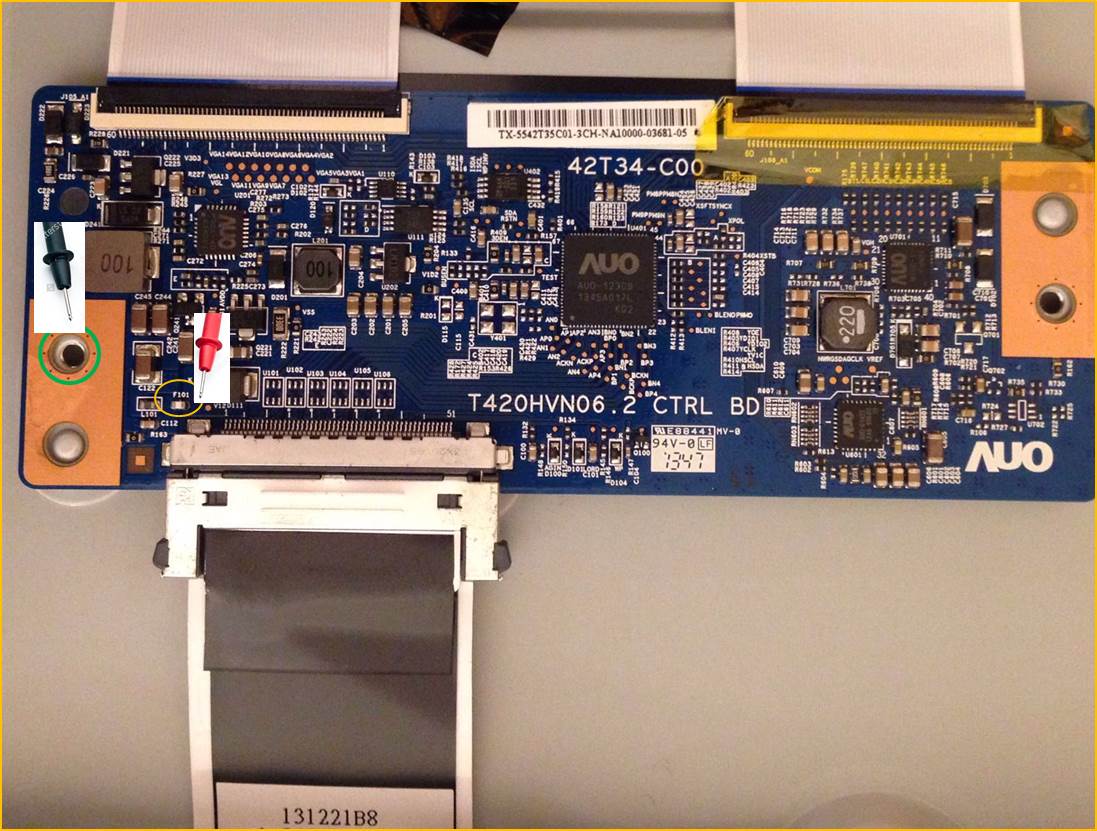

        Did you check the DCV on both ends of the SMD fuse with ref to the chassis to see if the T-CON is getting the 12VDC? It is not going to be easy due to the location of the T-CON board.

          Have you checked F101 on the Tcon. Recently received a Tcon where the fuse was blown.
            F101 appears to be fine. It's going to be awkward but where would I put the test probes to test if 12v is coming in? I assume tv needs to be switched on. Apologies been a since I done any electronics
              Black probe on the chassis Gnd, red probe on the fuse's ends (check DCV at both ends), TV has to be ON.

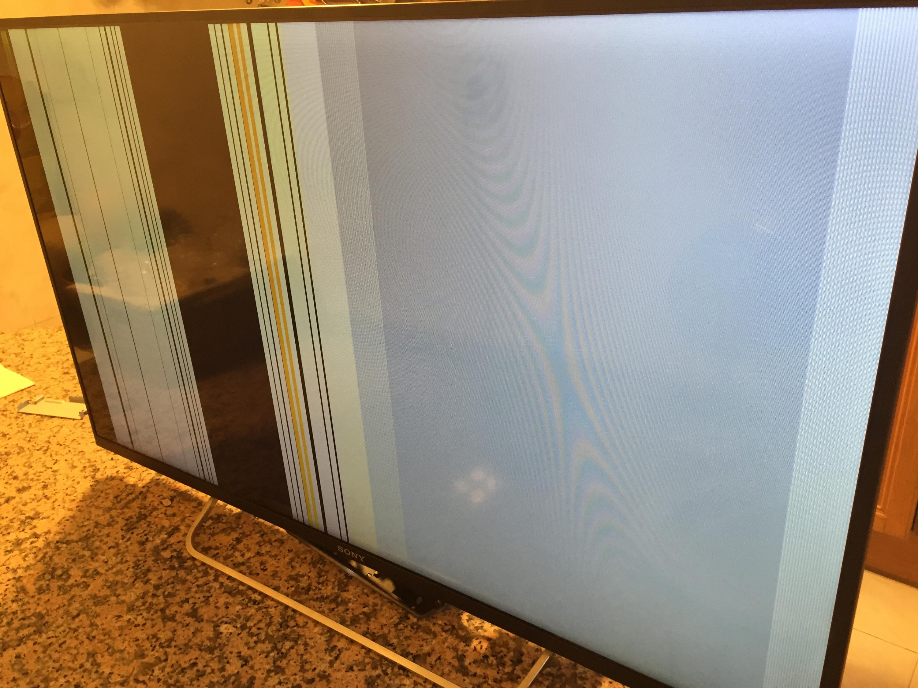

                    This are the Symptoms in na attached video:
                    https://drive.google.com/open?id=0B_...UtEZklmYUliZzA
                    Can it be T-Con?

                            I made some more tests. I unplug one of the cables of T-Com and the result was this in the photo. No image. I do the same on the other cable and the result was the same. No image in none of the sides.
                            Any help?

                                That looks like a bad t-con or bad panel! You need to measure the voltages as described above!
                                The T-con had a small fuse ( usually ) next to the LVDS port. Its very small and says something like "F101". Measure for continuity and measure the voltage.

                                  Can someone confirm that I have understand correct the possition of the probe of the multimeter? (I attach a picture).

                                    Screw your tcon board back down. Black lead on chassis. Red lead on one side of the fuse and read dc voltage, then red lead on other side of fuse and read dc voltage and the readings should be identical.

                                        Yep, unscrew metal shields from the bottom of the LCD. Something like this.
                                        http://www.imagebam.com/image/219837503058597
                                        Check burned routes on the flexible cables. Something like this.
                                        http://www.imagebam.com/image/913b54503058762
                                        Congratulations, you got a s/c in your LCD. Yes, its time to buy a new TV
