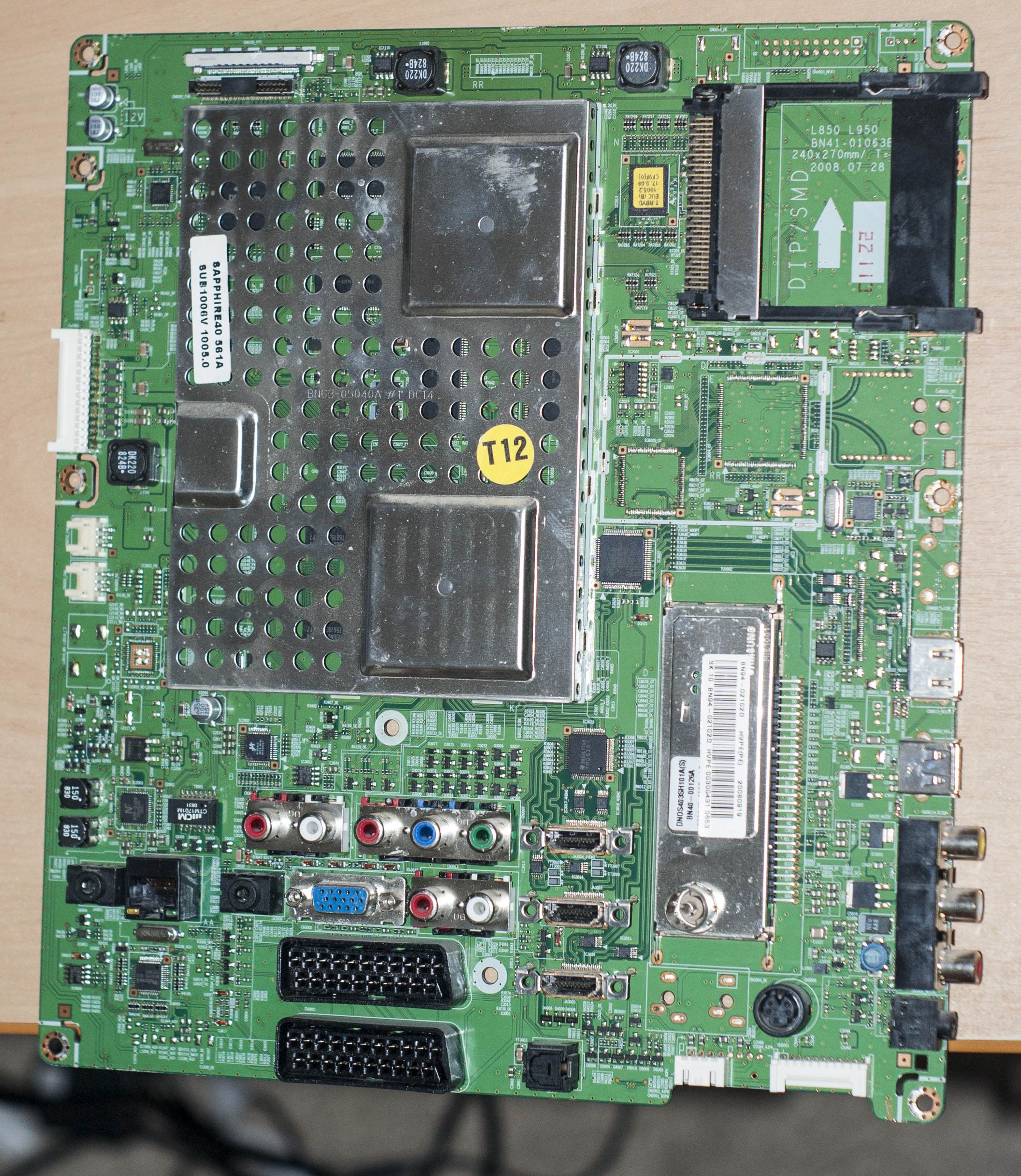

      Re: LE40A856S Dead, Troubleshooting
      Clear sharp pictures of both the main boards for comparison would be helpful. It may well be that you have a board for the same model set but for a different lcd panel therefore different firmware installed.

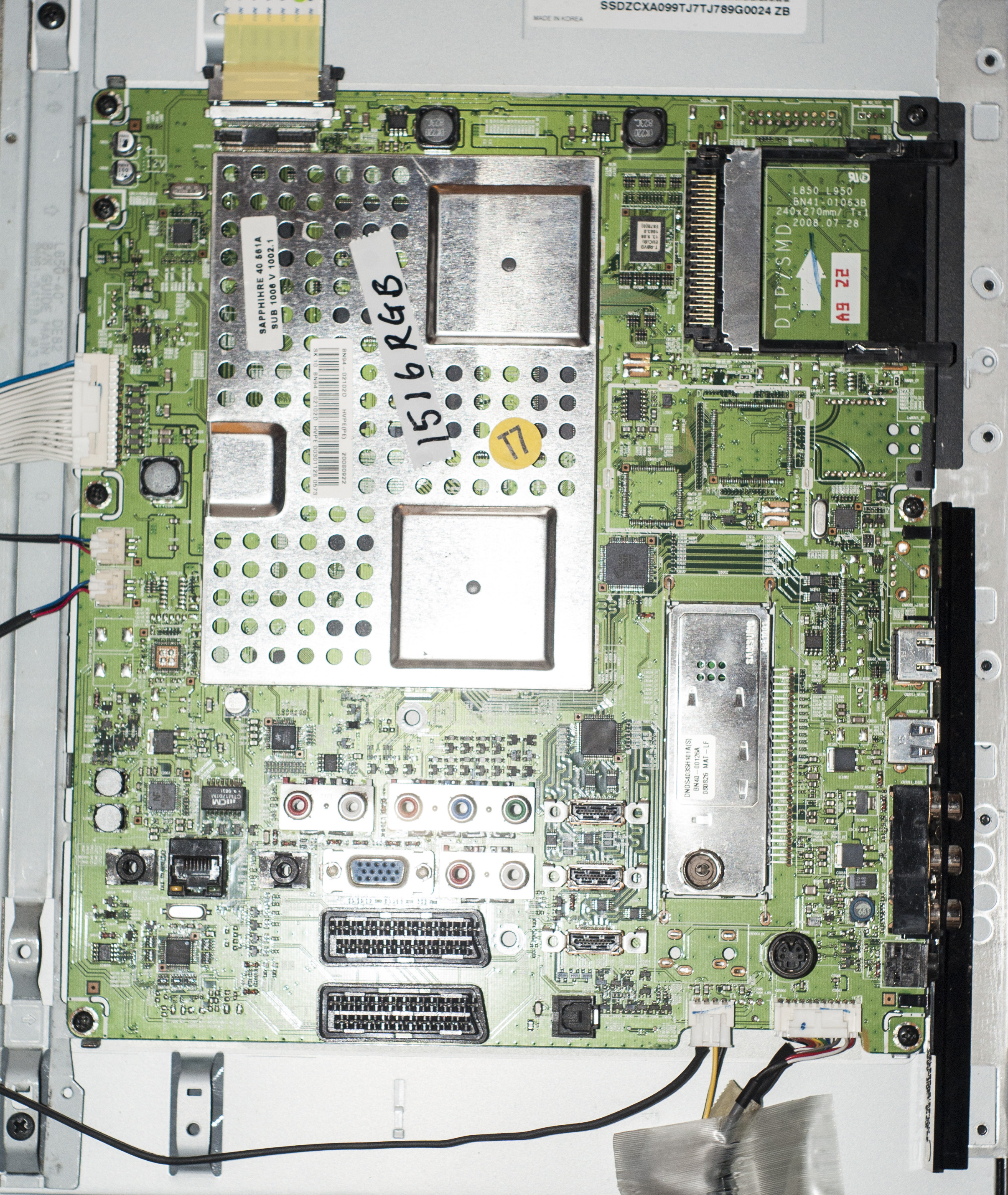

      • MrGizmo
        • Nov 2016
        • 4
        Thanks for the responses --
        The part numbers are:
        Power board: BN44-00245A
        This one I have the original back in place as the new one now, both appear identical.
        Main board:
        BN41-01053B
        Hires pics of both attached.
        I hadn't noticed until you mentioned the stickers -- my board has a 1005.0 as the last number on the sticker and the replacement has 1002.1.
        Revision number?
            Mrgizmo,
            The main board part number starts with bn94 and will be located on a bar code sticker. The board number starts with bn41 and will be printed directly on the board. If you purchase a main board based on the bn41 number then you more than likely will purchase the wrong version or incompatible version.
            However the boards above have the same BN94-02102D part number so they should work with one another. You may have just gotten a bad main board.
