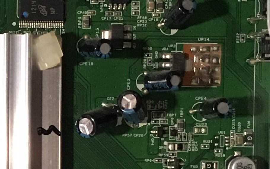

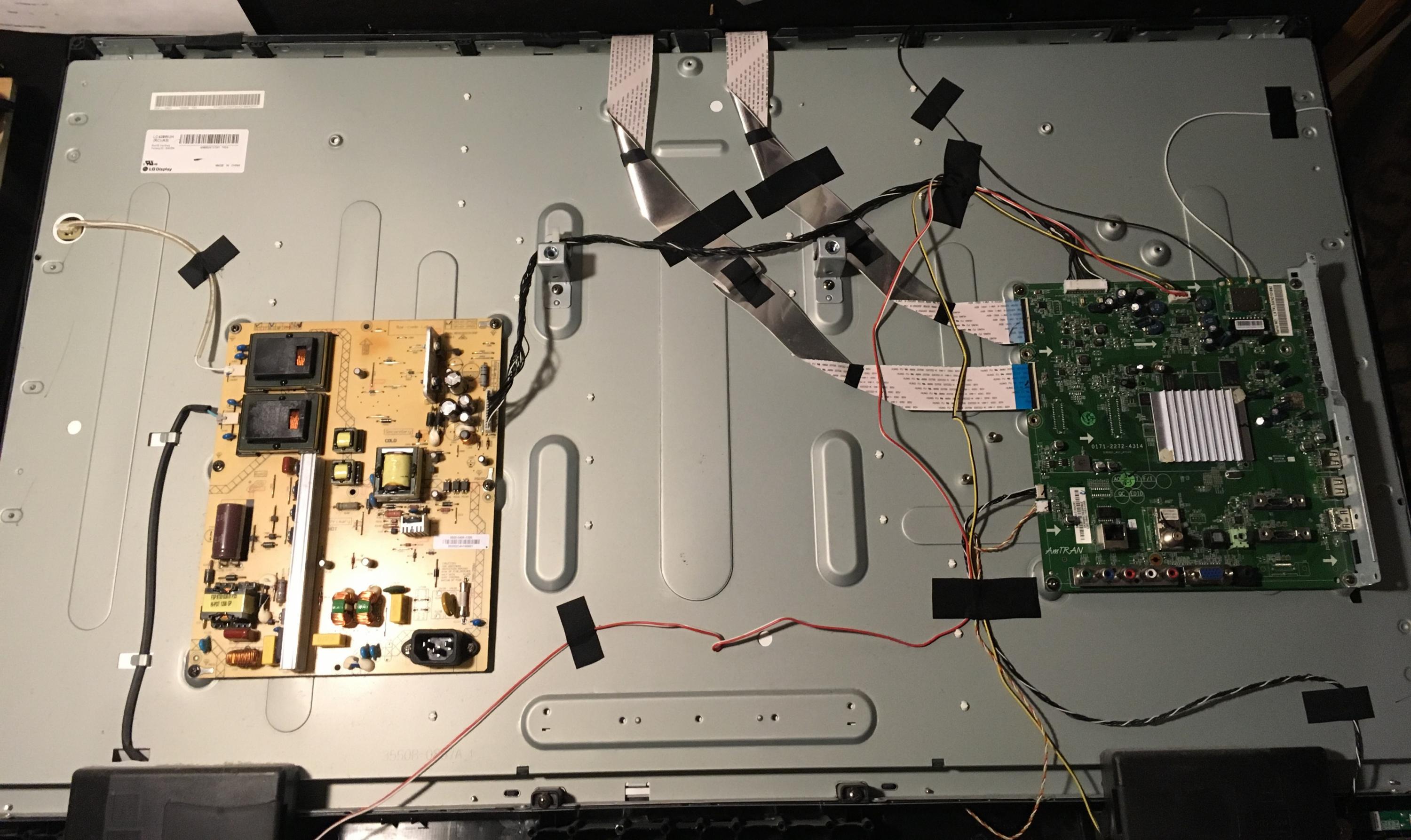

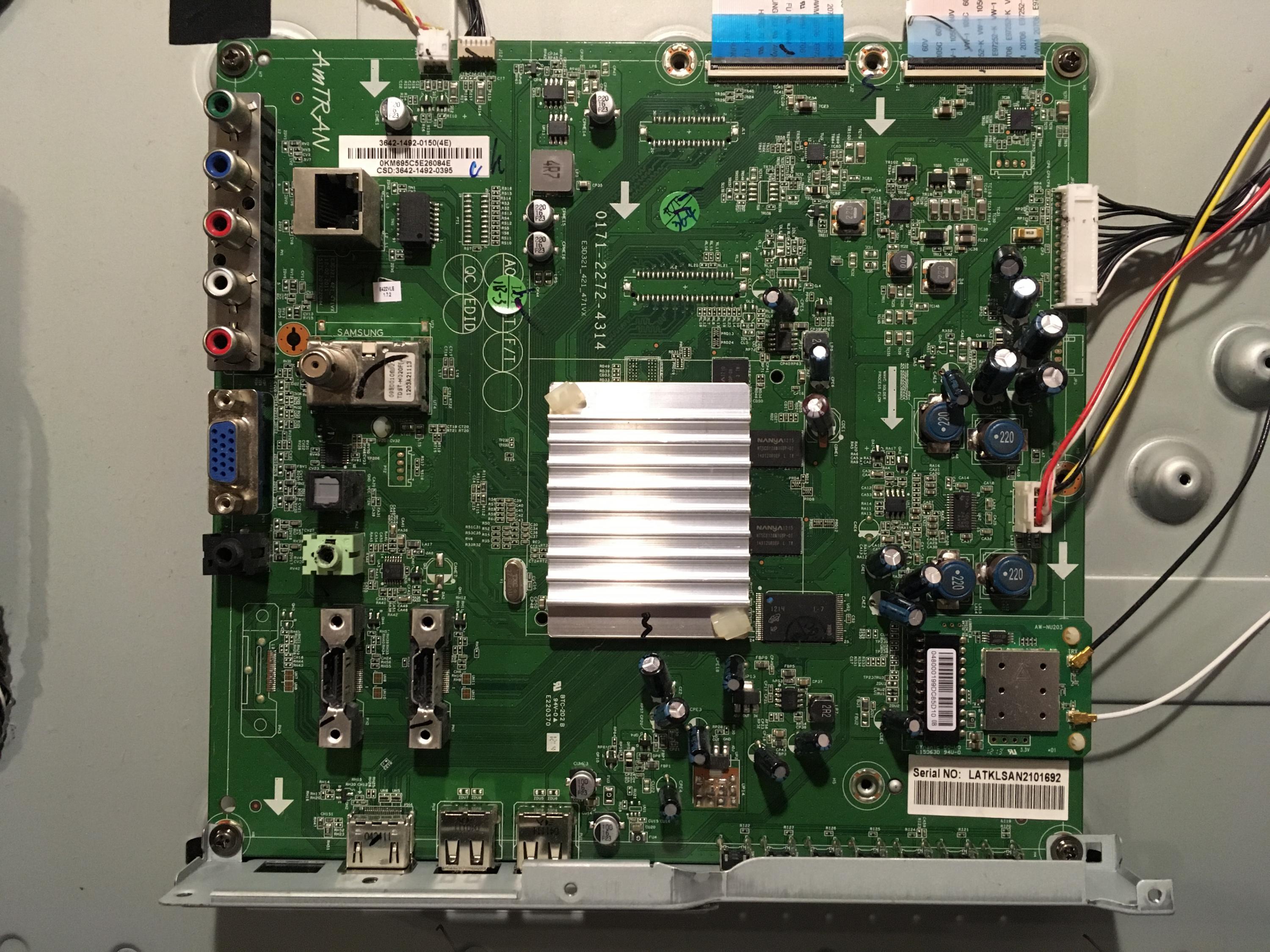

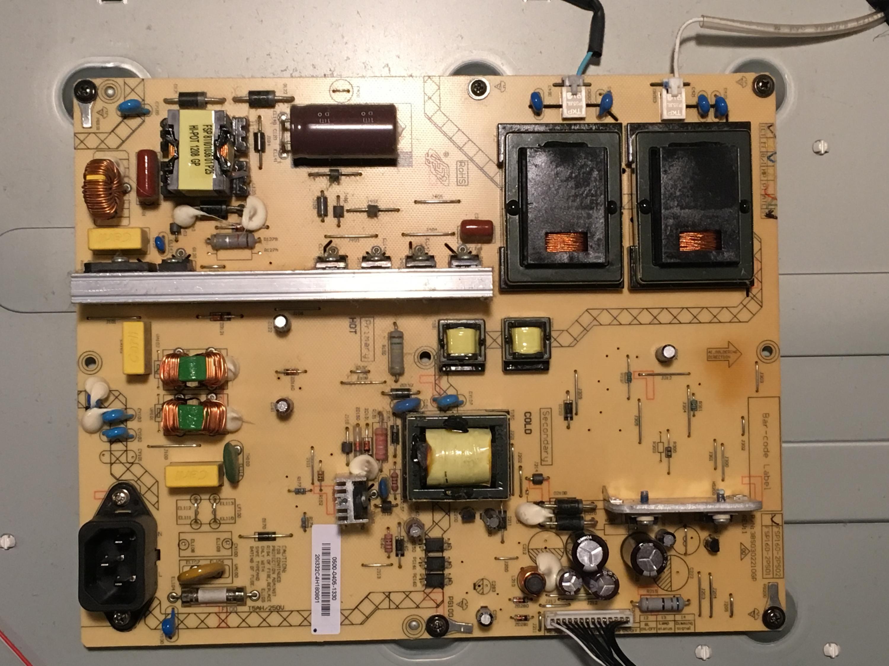

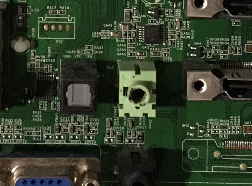

    I have a Vizio E422VLE that has start-up issues. When turned on after being off a few hours, it takes about 20 minutes for it to display the screen properly. This model has only two boards, power supply and main board (see photos). When I received this TV I found that the stereo audio out port had issues as well. It appears that a 3.5mm jack had been broken off in the port and an ink pen was used unsuccessfully to get it out. I removed the port (after taking the included photos) and the problem still exists. The port had three pieces of metal inside it. One thing that I did notice after removing the port is that the menu now worked correctly. Before removing it, the menu would not stay on the screen and the information displayed at the top right (input, channel #, etc) flickered and did not disappear as it should have. Now that the port is removed, the menu functions properly. The problem with the screen still exists. In short, during the first 20 or so minutes after cold start, only the top inch of the screen works properly. The rest has displays various screen states: vertical lines, black areas, faded area. I cannot adequately describe this behavior so I recorded a video that demonstrates from start-up to the time it actually functions as normal, about 20 minutes later. Please check out the video at (https://www.youtube.com/watch?v=0TpqaZntiq8). I would appreciate any suggestions you might have. I also checked the voltages from the power suppply to the main board and they are as they should be. I also checked what I believe are the voltage regulators (cannot locate a service manual).

    UP13: (In) +3.3v (Out) +1.199v (Adj) +2.2mv
    UP2: (In) +5.25v (Out) +3.3v (Adj) +2.04v

    Use a hair dryer to see if heating up any part of the circuit boards brings the picture up quicker.
      Re: Vizio E422VLE screen problems when cold started. Works fine after 20 minutes.
      Thanks dick_barton. I will give it a try and report back.
        Unfortunately the hair dryer did not affect the behavior. I tried it on both the main board and the power supply/inverter board.
          Try warming up the pcb strip hidden in the bezel which the two LVDS cables run to.
            Thanks. Will give it a try.
              Bingo!!!!
              Great call dick_barton .
              It took about one minute for it to start operating normally.
              Now I just have to isolate it.
              Thanks a bunch.
