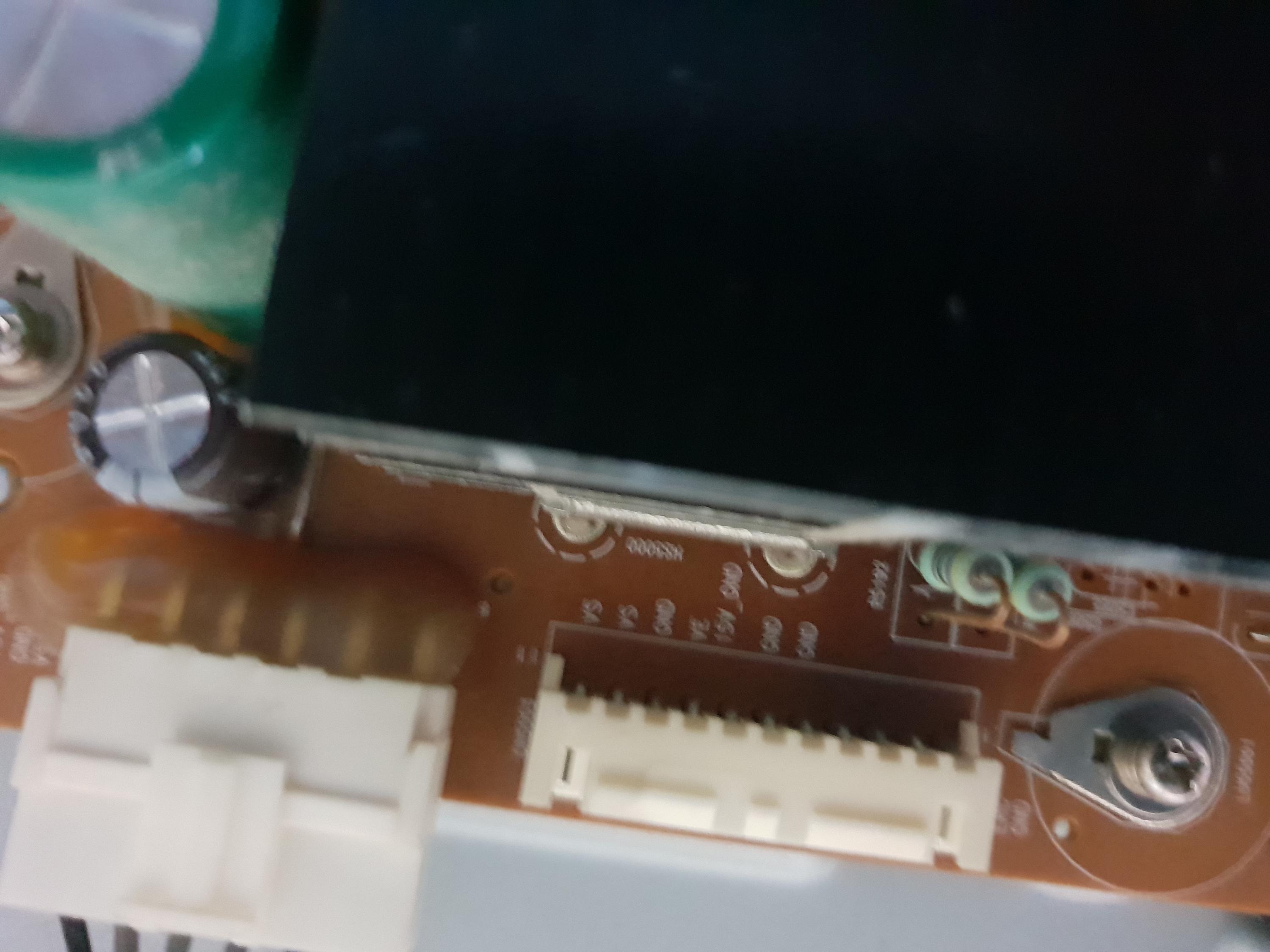

    it turns out i was wrong. i proceed to measure every possible voltage on the SMPS board. and i found that
    both of my Vs dropped from like 110+ to about 10V when i powered on the unit.
    and voltage of my Va is inconsistent in 10V+
    https://imgur.com/a/syJ5wNm
    standby voltage and other dc5v are fine

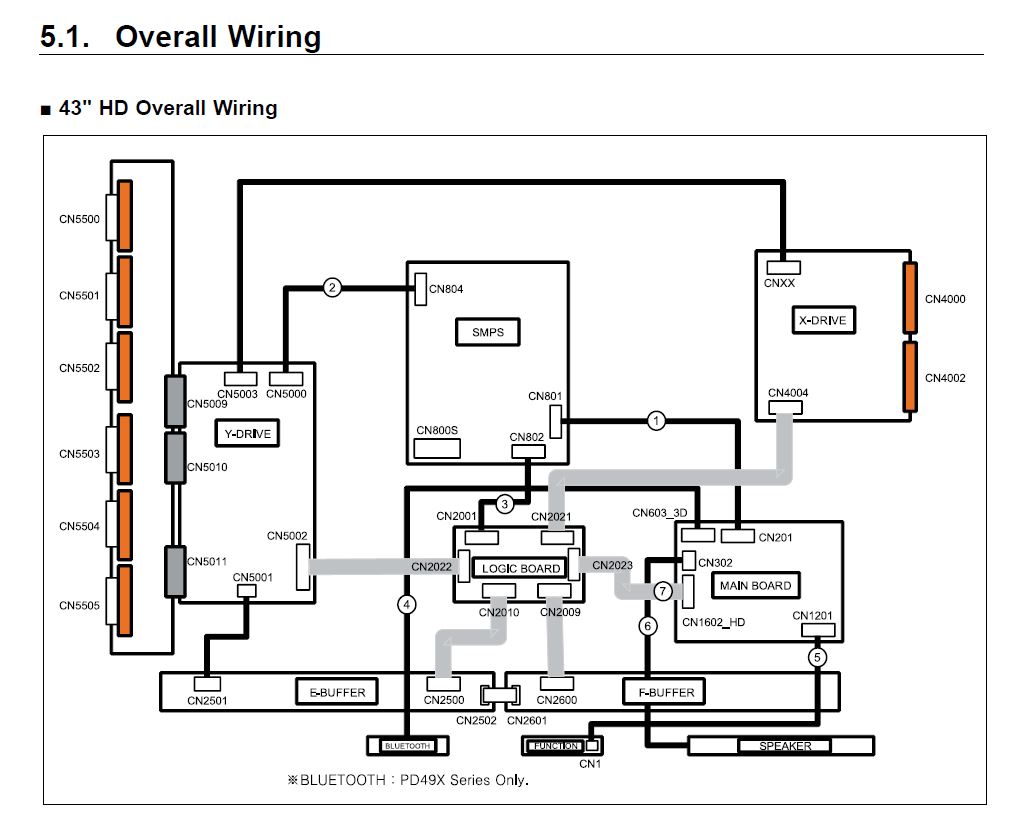

              Re: PN43D490A1DXZA power supply broke?
              with reference to the pic
              unplugCN5003-CNXX--leaving y sus--blinking error
              unplug CN804-CN5000--blinking stops and stable green light
              and more importantly theres a clock ticking sound..which may be caused by the relay.i am not sure about it.

                                i was wondering is there any way to test the x main individually since its power source comes from y main.....
                                tested the voltage of ymain it went very wrong with Vsc=-0.015V
                                and i test the ouput voltage from ysus connector to the xsus it doesnt add up.

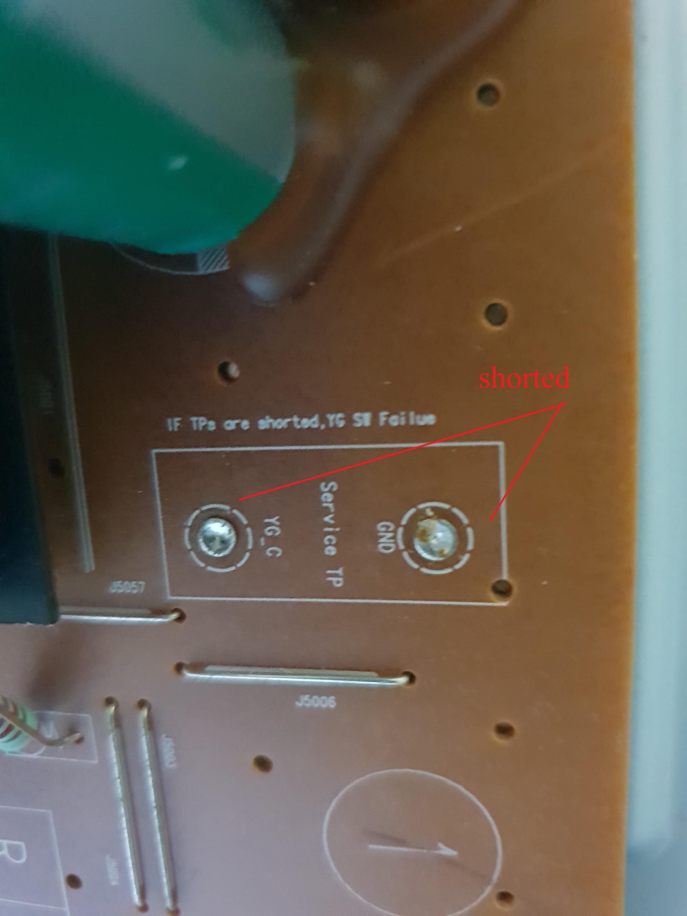

                                      tps shorted, should be y board failure
