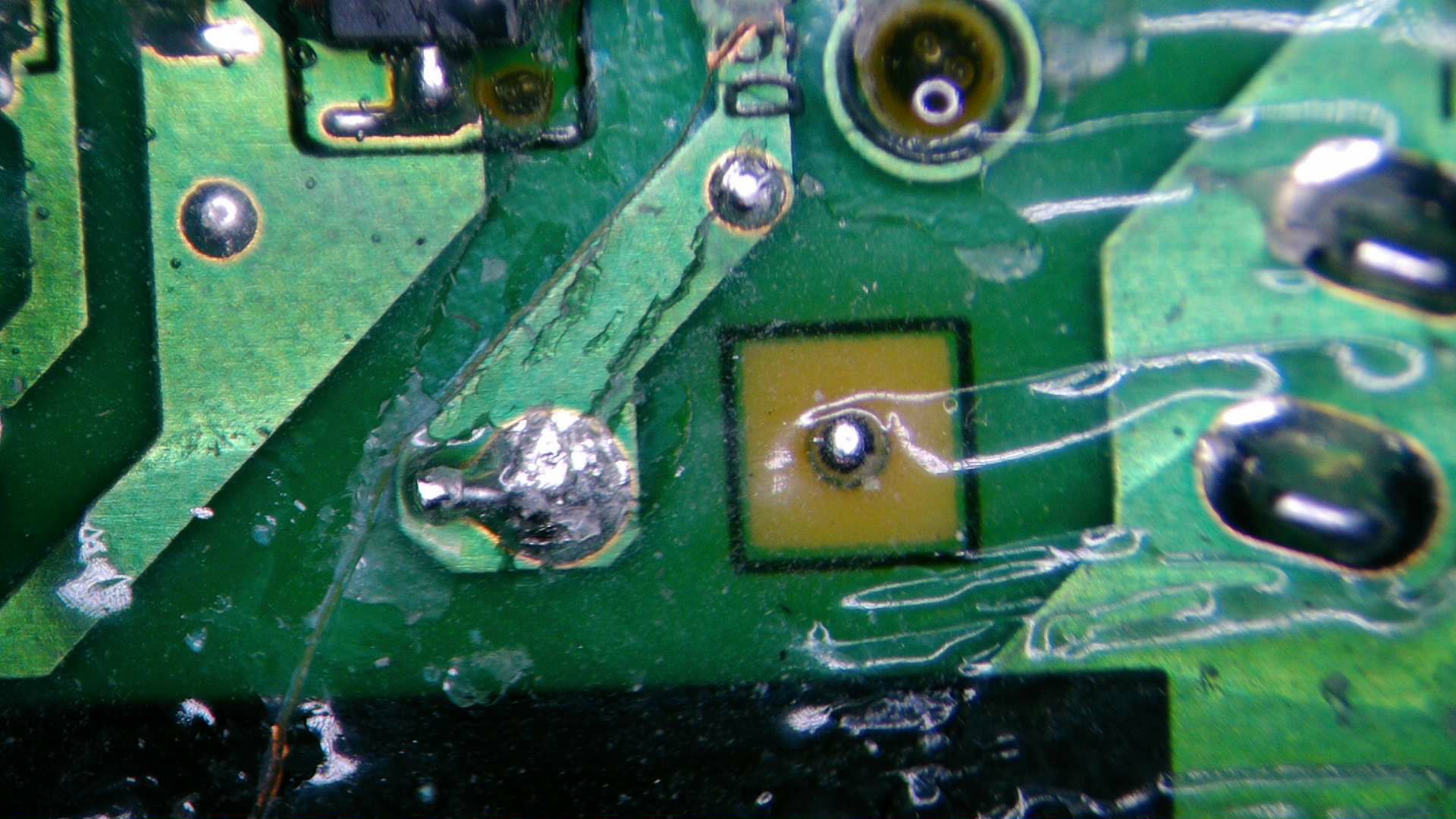

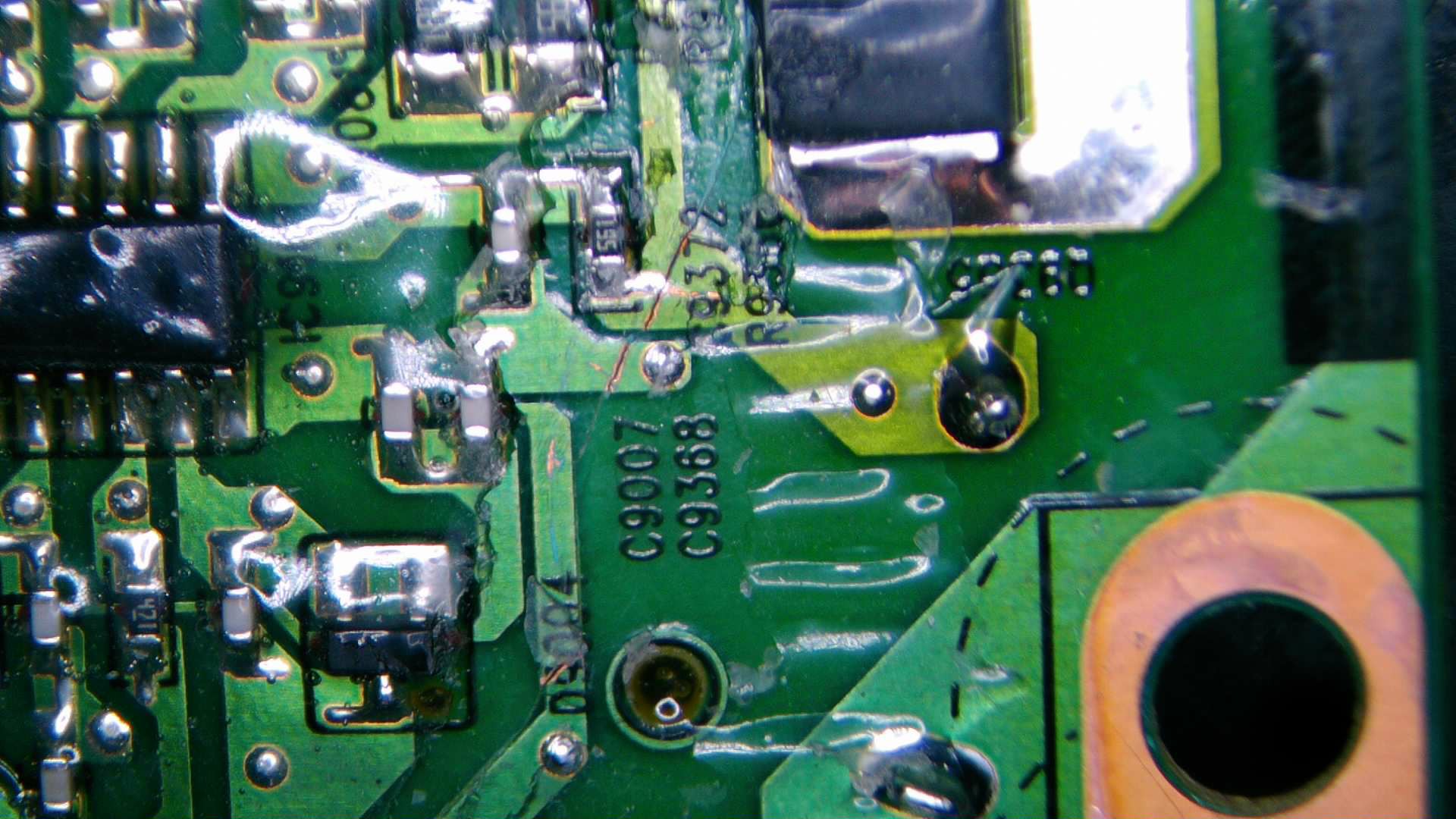

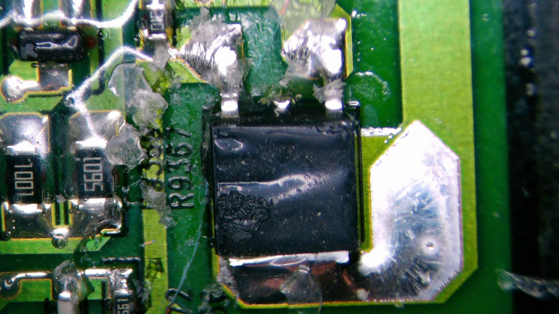

                                  Thanks Budm. I was doing checks and found this . Look like this is the problem. The board has a small crack all way down it.
                                  Pic is below
                                    Re: Samsung un55mu6500fxza no power
                                    You going to do lots of wire jumpers on that board.
                                    So is this you TV or is it from some one else that worked on it before you?
                                    You should also be able to see the hairline cracked on the top side, this is why it is important to show good clear pictures of the boards.
