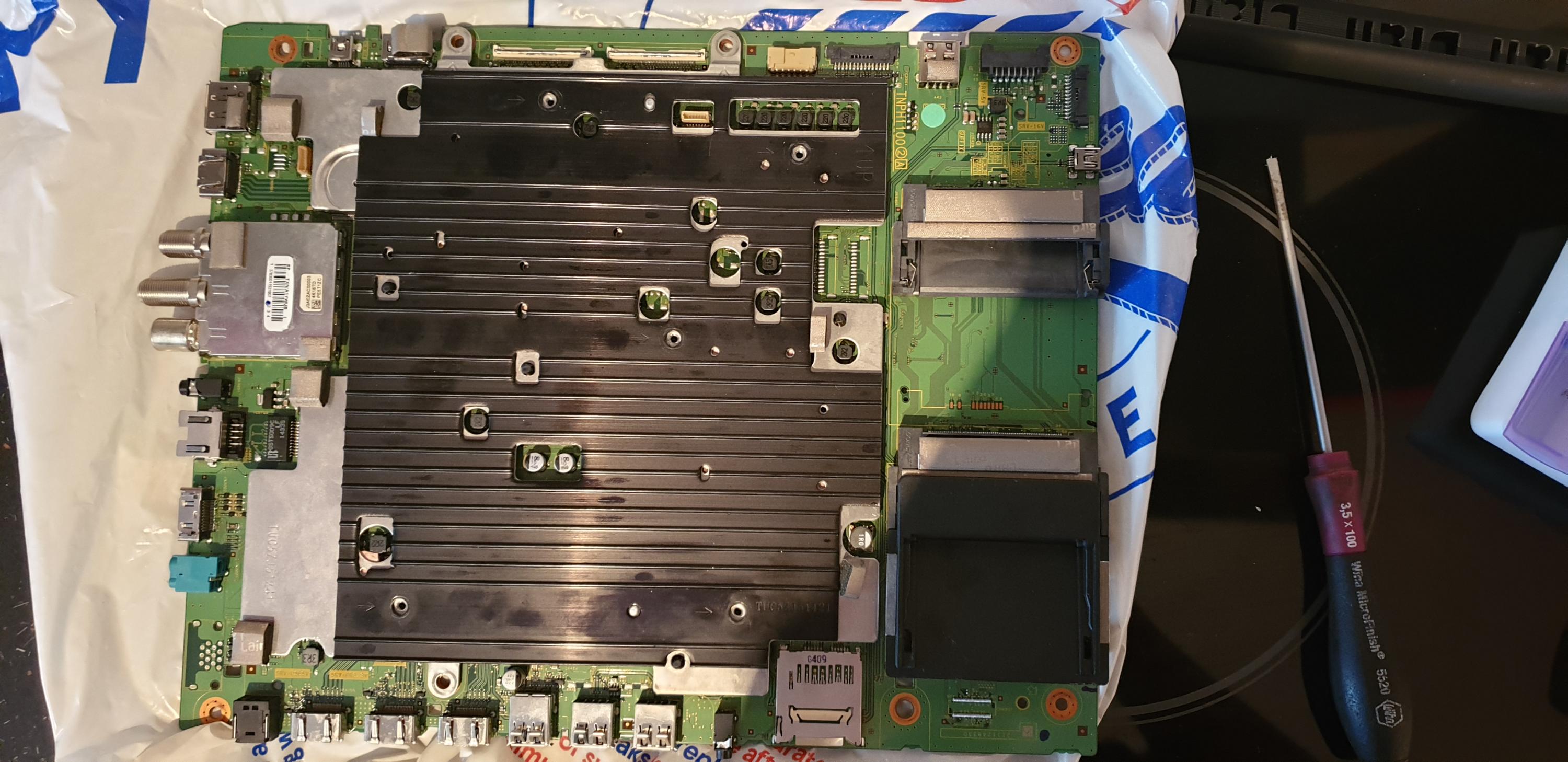

                                  Re: Panasonic 58-TXAX802B Stuck on Panasonic Logo
                                  As requested photos of board I numbered so you can see and reply easier with the number of chip ect
                                  I tried doing a usb firmware update but it doesnt even let you do that it just starts up stays on panasonic logo then turns of and gives u 13 flashes which I believe is loss of communication so could that be the big chip number 1
                                  Or if not what part holds the firmware on the tv
                                    1, 2, and 3 look like processors. I see RAM connected to No1, are all four black rectangles identical as a couple of them are obscured.
                                      Oh what an idiot I am I knew they were processors why did I think it was that part I needed lol
                                      The bit I need is where the firmware is installed
                                      I will take a closer picture for you of the area you mentioned and check them out and get back to you in a bit but I think they are the same yes but il check again
                                        Hi yes all 4 look identical to me
                                        I took few more photos if they are any good
