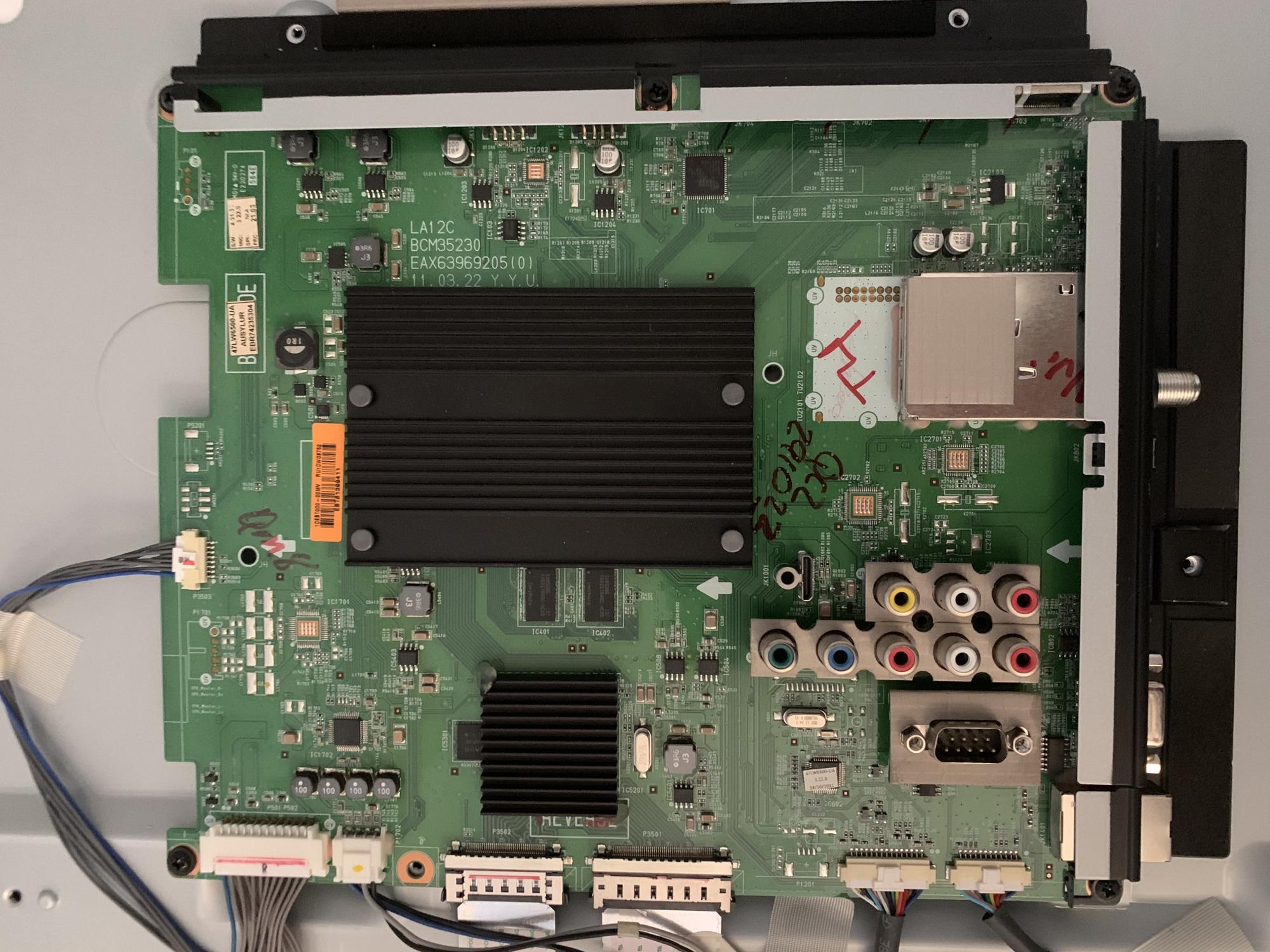

    My TV suddenly stopped working and when trying to turn on, just the standby lights come up and the screen does not light. I opened it and tried to debug based on a training manual I found on these boards for a similar TV, but the voltages do not match so I am not sure how to identify the problem. Here is some info:
    LG 47LW6500-UA

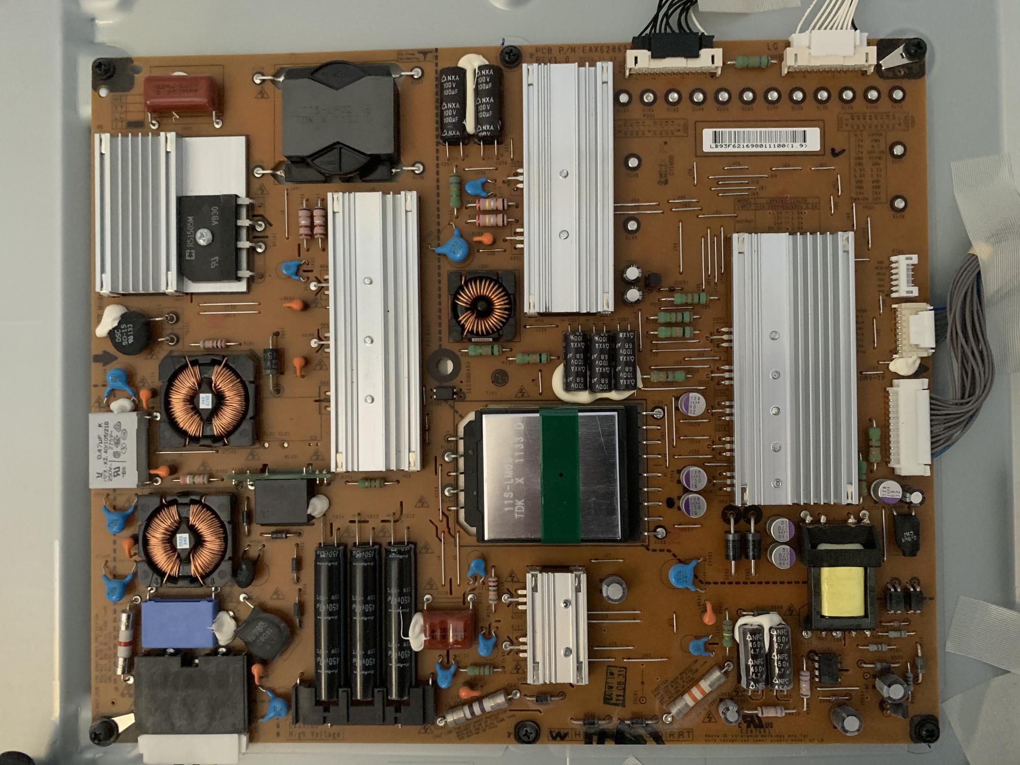

    Power Board: EAX62865401/8 / EAY62169801
    Main Board: LA12C / BCM35230 / EAX63969205(0) / EBT61399411
    So here is what I did so far:
    TEST1
    - Removed P502 on the main board
    - Jumped pins 1 (PWR_ON) with 9 (3.5V STBY)
    - P201 (pins 17, 19 and 21) show 11.94V
    - P201 (pins 2, 3 and 4) show 24.05V
    - P202 (pins 1 and 12) and P203 (pins 1 and 13) show 35.82V
    TEST2
    - Jumped pins 10 (3.5V STBY) with 18 (DRV_ON)
    - P201 (pins 17, 19 and 21) show 12.21V
    - P201 (pins 2, 3 and 4) show 23.8V
    - P201 (pin 18 DRV_ON) shows 12.21V
    - C256+ leg, P202 (pins 1 and 12) and P203 (pins 1 and 13) show 52.9V
    - LEDs light up
    TEST3
    - Removed jumpers and put P502 back on the main board
    - Powered the TV on -> LEDs do not light
    - P201 (pins 17, 19 and 21) show 11.85V
    - P201 (pins 2, 3 and 4) show 24.22V
    - P201 (pin 18 DRV_ON) shows 11.85V
    - C256+ leg, P202 (pins 1 and 12) and P203 (pins 1 and 13) show 36V
    - Attempted to monitor voltage jumps when turning the TV on on C256+ and P202/203, it never goes above 36V
    Is this a bad motherboard or a bad power source? Any ideas on what else to test and what next steps to take?
    Thanks!

        Re: 47LW6500 Debug Help - Power Board or Mainboard?
        Ok, here are the values for P201.
        Standby
        Code:
        23 - N.C   -> 0V     |  24 - ERROR  -> 0V
        21 - 12V   -> 0V     |  22 - PWM   -> 0V
        19 - 12V   -> 0V     |  20 - N.C   -> 0V
        17 - 12V   -> 0V     |  18 - DRV-ON  -> 0V
        15 - GND   -> 0V     |  16 - VSYNC  -> 0V
        13 - GND   -> 0V     |  14 - GND   -> 0V
        11 - 3.5V   -> 3.52V   |  12 - 3.5V   -> 3.52V
         9 - 3.5V   -> 3.52V   |  10 - 3.5V   -> 3.52V
         7 - GND   -> 0V     |   8 - GND   -> 0V
         5 - GND   -> 0V     |   6 - GND   -> 0V
         3 - 24V   -> 0V     |   4 - 24V   -> 0V
         1 - PWR-ON  -> 0V     |   2 - 24V   -> 0V
        Power
        Code:
        21 - 12V   -> 11.84V   |  22 - PWM   -> 3.2V
        19 - 12V   -> 11.84V   |  20 - N.C   -> 0V
        17 - 12V   -> 11.84V   |  18 - DRV-ON  -> 0.03V
        11 - 3.5V   -> 3.51V   |  12 - 3.5V   -> 3.51V
         9 - 3.5V   -> 3.51V   |  10 - 3.5V   -> 3.51V
         3 - 24V   -> 24.21V   |  4 - 24V   -> 24.21V
         1 - PWR-ON  -> 3.44V   |  2 - 24V   -> 24.21V

          I have found with the LW series LG LED TVs that the BGA chip becomes disconnected from the Main Bd. Remove the Heatsink and using a Hot air Station and heat the BGA chip for 15 mins at 350 degrees. allow it to cool on its own and refit the Heatsink and give it a try. I have successfully done this accouple times already without any call back complaints.

              You are correct sir, the drv_on signal comes from the mainboard when functioning properly.
                                So here is what I am seeing on the T-CON's voltage circuit on the main board:
                                Q505
                                - B - 0.628V (PANEL_CTL)
                                - E - 0V (GND)
                                - C - 0.03V
                                Q506
                                - B - 0.03V
                                - E - 0V (GND)
                                - C - 12V
                                Q507
                                - D - 0V (PANEL_VCC)
                                - S - 12V (from L511)
                                - G - 12V
                                Does this make sense to you? I am not sure what PANEL_CTL value should be, but the D pin on Q507 should be 12V in order to power the T-CON board.
                                Thank you.

                                  PANEL_CTL is likely a logic signal that comes directly from the microprocessor through a BGA connection. Try heating up the processor with a hair dryer before plugging in to confirm you have bad BGA solder balls.
                                    So beside not having DRV drive signal, you also have T-CON power control signal.
                                    Q505
                                    - B - 0.628V (PANEL_CTL) This should change states when you toggle TV on and off, does it?
                                    - E - 0V (GND)
                                    - C - 0.03V
                                    Q507
                                    - G - 12V Since this MOSFET is P -Channel, for it to be on, the Gate Voltage has to be at least 3V less than the Source Voltage, this why you get 0V on the Drain pin at this point due to Gate Voltage is at 12V.
                                    So the MICOM is not working correctly at this point.

                                      PANEL_CTL on the base of Q505 barely changes voltage when toggling TV on and off: 0.6V when off and 0.63V when on.
                                        The MICOM is not sending the control signal for this section of the circuit beside the DRV circuit.
