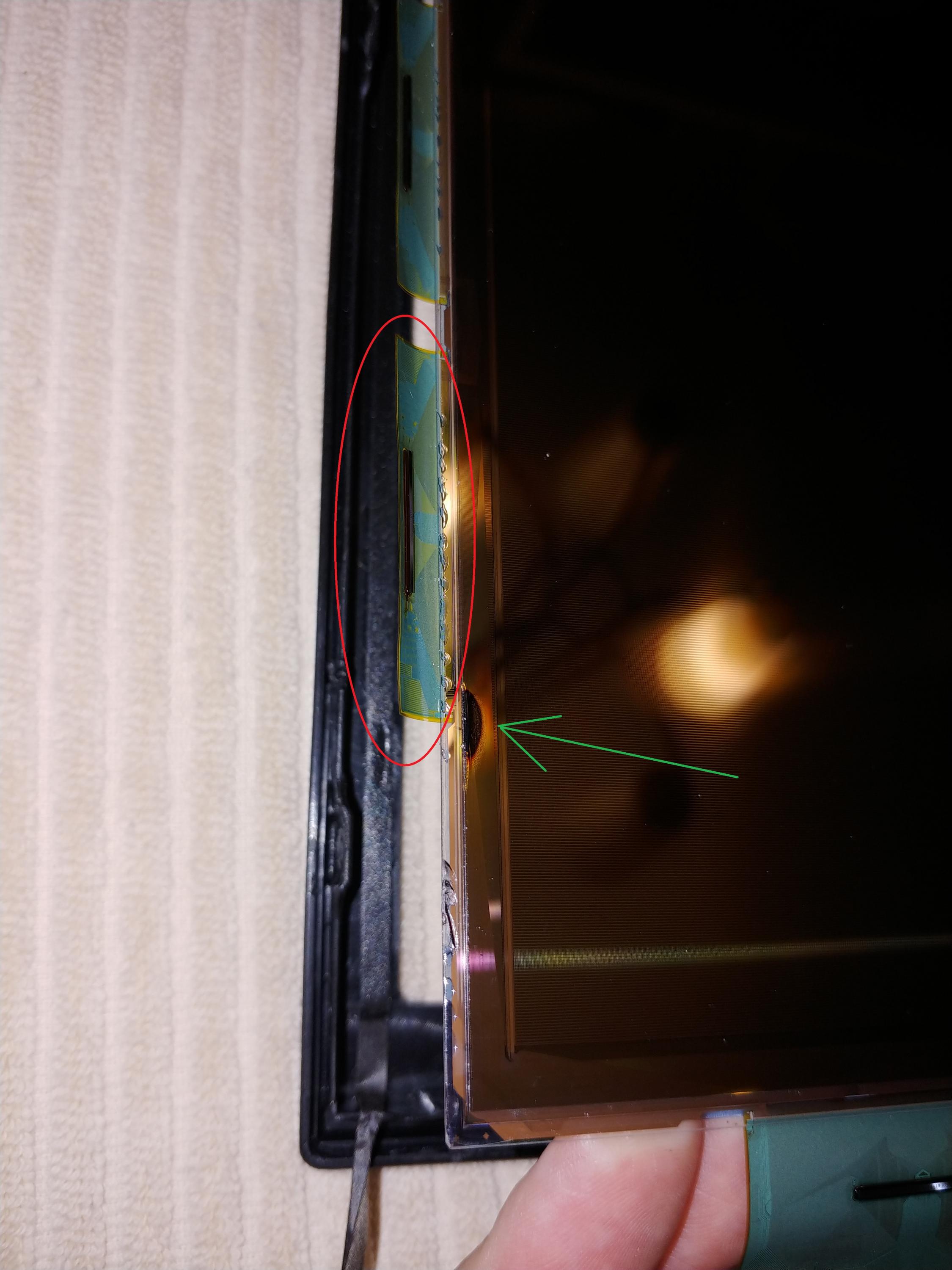

          #44
          Re: Bad T-con or bad panel??
          Well your latest picture looks like what I've seen many times but doesn't have to be, it looks like you have a bad tab bond connection on that side. If it is some have had good luck with "shimming", there's quite a few videos on youtube covering the technique.
          ps, Please don't attack me.
          Just want to make sure i know what your talking about. By tabs are you referring to what I have circled in red in the attached picture.
          Also i'm still not quite sure what to make of the spot pointed to by the green arrow. Is this damage from a short or is this common to see in these panels? (as I said before I do not have much experience with lcd panels)

            #45
            That's a good picture, it's so close up I can't tell, is it on top bottom or side, can you show more pictures maybe not so close up?

                #47
                that is the lower left side (if looking from the back of the display). I don't have any other pictures right now. I can take some when i'm home tonight if that will help.
                is that what you mean by tab? or do you mean the ribbons connecting the panel drivers to the panel?

                  #48

                    #49
                    Yep, do diah's test again, see what you get.
