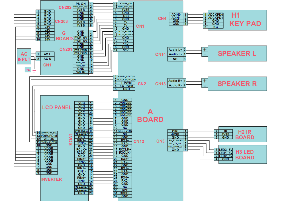

    Symptoms:
    ~ no panel lamps
    ~ SER tests showed no bad caps this time and no bulging caps visible
    ~ all fuses test ok
    See attached block diagram from service manual.
    Service manual can be downloaded after registering with the site: http://www.scribd.com/doc/21548740/C...00-KDL-37L4000
    Board-G is the SMPS
    Board-A is the video control board
    ~ board-G, CN202: "4VSB" pins 3, 7 & 8 have 4Vdc
    ~ other power outputs: 6Vdc, 15Vdc, 30Vdc, 24Vdc & Board-G, CN201,pin7&8 "PWR_PANEL" are at 0Vdc
    ~ "POWER ON" signal at Board-A(CN1 pin 13) and also "PS-ON" at Board-G(CN202 pin 1) are connected and at a logic low(0Vdc). The "PS-ON" signal originates from the controller IC on Board-A.
    ~ "PWR_ERR_DET" on Board-G, CN202-pin2 & Board-A, CN1,pin15 are 0Vdc
    ~ I verifyed the operation of the power button input at Board-A, CN4
    This power supply has been a real head-scratcher, folks.
    Because the "PS-ON" signal originates from the controller IC on Board-A the defect could be on Board-A. I would like to verify the power supply before replacing the controller board (Board-A).
    Is there any way to verify the power supply board on its own?
    Any advice would be greatly appreciated.
    Thank you.

    Dang, you get interesting problems.
    I see three ways to proceed.
    1. Test the power supply by providing the proper loads and driving PS_ON high.
    2. Isolate the PS_ON line from the controller and drive it high. This uses the circuit boards as the load.
    3. Wait for Wizard.
    I'd bet on the A board as the culprit. If it were good it should drive the standby LED on. This logic is tenuous at best.
    PlainBill

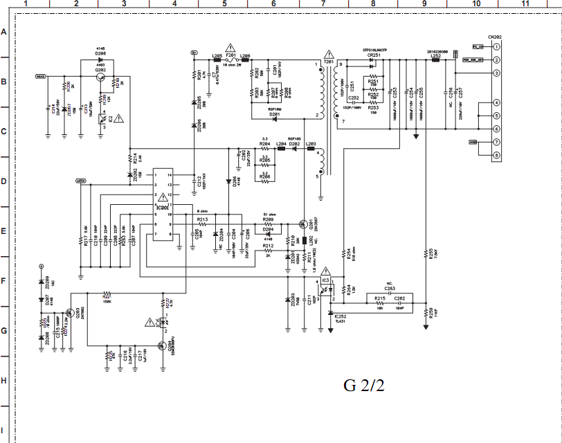

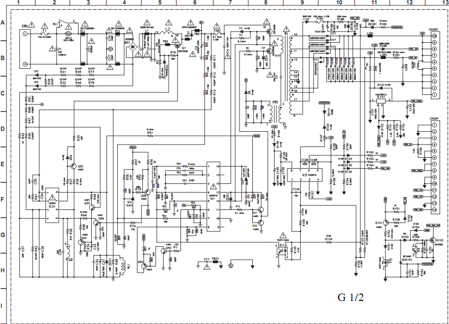

          I had a probe slip and fried Q3 (2sk3568 mosfet, schematic 1of2, position A-8) so I do not have a measure of the floating voltage of the "PS-ON" lead but I seem to recall that it was 4-5Vdc.

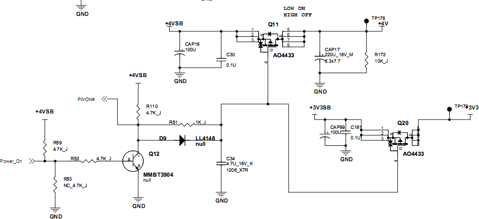

          In the mean time I started tracing "PS-ON" which comes from "PWON#" on Board-A. see PSON.png
          It seems that the surface mounted resister, R53 is missing. By the smooth solder mounds at the component location I would guess that the resister was never on the board to begin with. ???
          Still tracing...
          The "Power_On" signal comes directly from the micro-controller IC, U18. R53 & R59 are a voltage divider that should maintain Power_on at 2Vdc when the 4Vdc stand-by is on. R52 is a current limiter for Q12.
          I am guessing that the U18 output "Power_On" is open collector (active low). If "Power_On" is active high then "PWON#" is active low.
          Is the "#" sign Sony's way of indicating active low?
          "PWON#" goes through a 0 ohm resistor (jumper) to CN1, pin 13 and then over to Board-G (power supply) as "PS-ON".
          If the micro-controller is pouched then Board-A would have to be replaced.
          That's all fine (not great as it was probably a manufacturing defect) but does not explain why the power supply resists being tested in isolation.

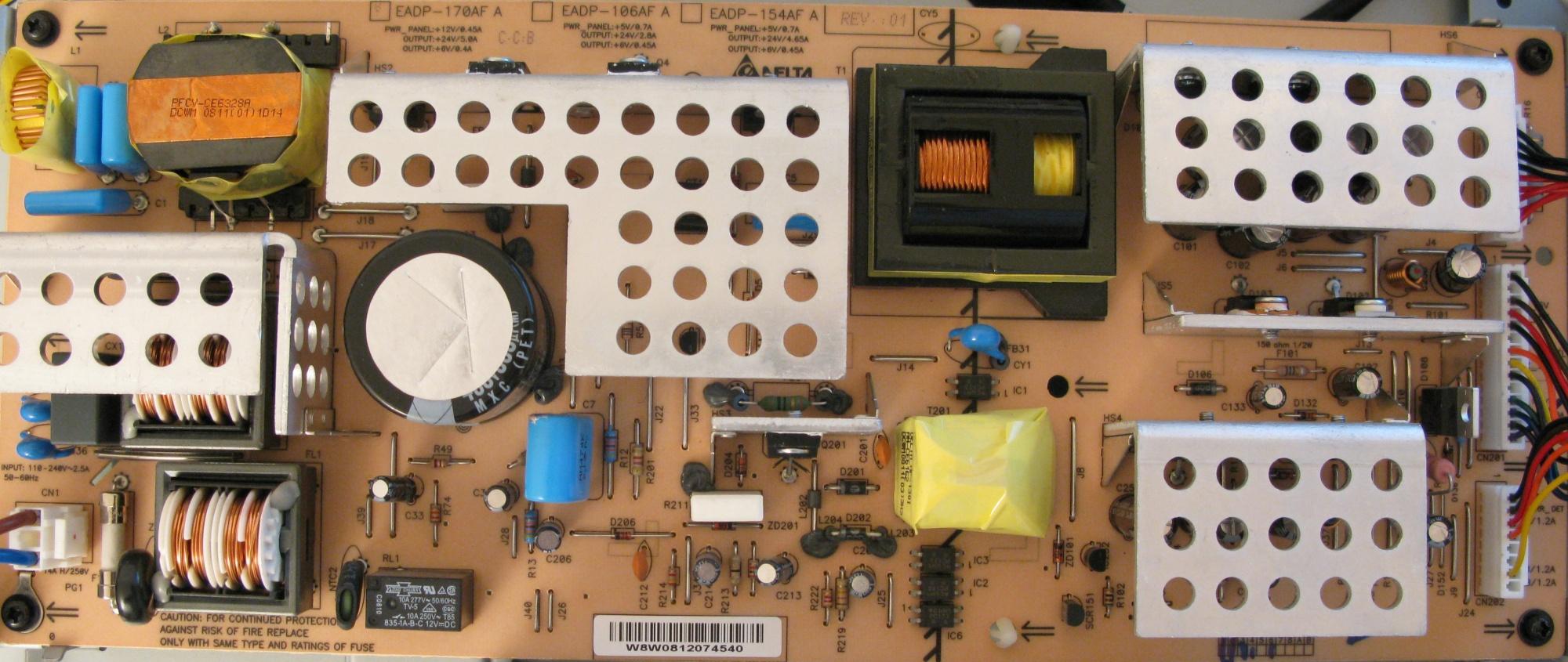

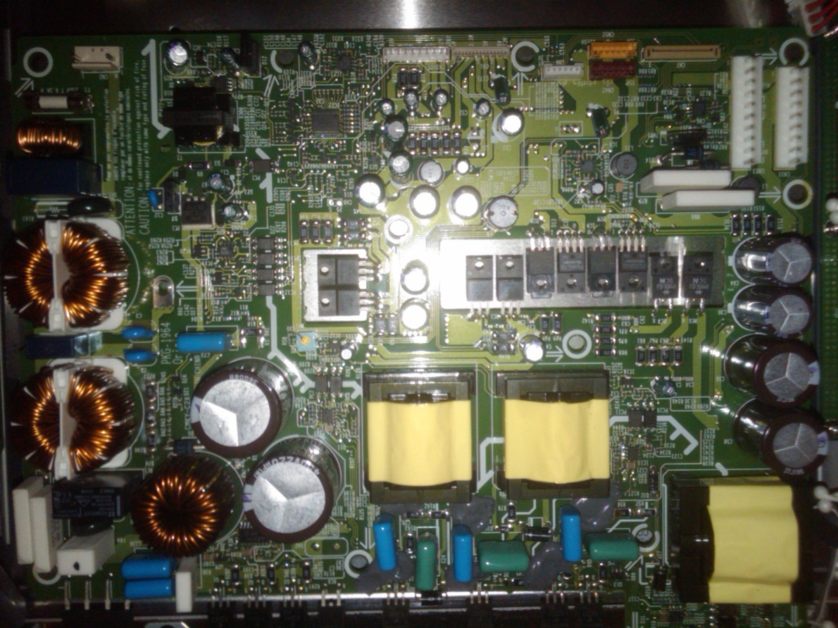

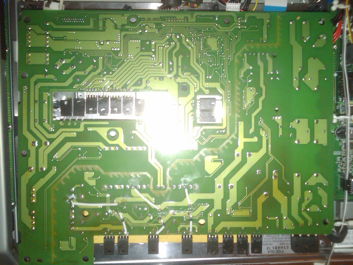

            I have the same TV, but my problem is the relay keeps clicking in and out. I don't see any visible bad caps, and the voltage out, where it's supposed to be 80v, goes up for a few seconds, I hear the click of the relay, and it drops back down to 0v. The actual power supply board is model PSE-324 (1-468-721-1) .. I read what you have above, must be a different PSU board in my TV, because the connectors out are CN23 and CN33.
            I've attached pictures, because quite frankly, I'm lost. Usually I can just point out the bad caps and replace them, and my job is done. This is also FAR more complicated than any LCD monitor I've taken apart. Recently I picked up a capacitance tester, but I can't seem to make heads or tails of it, either - it gives me different values than my multimeter set to test for continuity, and nothing seems consistent.
            Anyways, first picture on the left, near the top input voltage connector, is the blue relay that kicks in and out. The top right are the two connectors that should read 80v on the bottom 3 of each. They power the two side boards.
            Hoping someone can help

                Reconnect everything correctly and disconnect the PWR_ERR_DET. This should be floating high all the times. This could be detected as bad and A board refusing to turn on except it should blink out a error code.
                Ideally measure voltage of this PWR_ERR_DET connected or disconnected on the G board.
                Please monitor the PS_on or like to the SMPS (G board). Every time power button is pushed, should go up high or go low. Otherwise disconnect the PWR_ERR_DET and try again with your meter. If works, then probe all the other voltage outputs of the power supply.
                Do not forget to ohm the outputs to insure there's no short. I just fixed generic tv today. FSP SMPS was fixed and did not fix the TV and found another part that was damaged by overvoltage in mainboard.
                PS: please repost the pic of main SMPS in better detail, so I can look at it.
                Cheers, Wizard

                  No problem Wizard, I appreciate the response. I will take better pictures this evening and upload them. As for the PWR_ERR_DET, keep in mind my TV has a different board than Kevin's does - but I will measure the voltage output on the AC Input board, and try to find a schematic for that TV.

                    I've uploaded some better pictures at the above address, but for some reason I can't find my memory card or card reader for my actual digital camera, so I'm stuck with my blackberry pictures. I was unable to find a schematic, either.

                              The power supply for the KDL-32L4000 is a Delta EADP-170AF A. All Rubycon and Nichicons!
