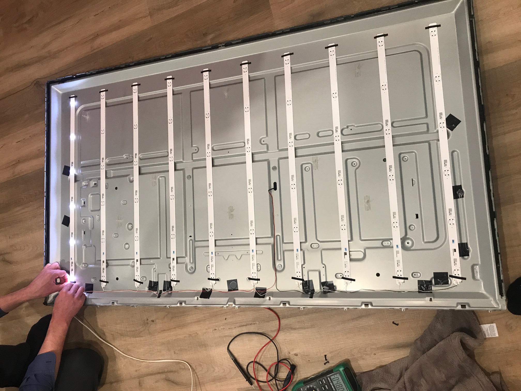

                Finally got around to taking the panel apart.
                Tested all the LEDs by supplying 18v to each strip and all of them light up.
                See picture.
                Unfortunately during installing the LCD panel it cracked.
                The TV is toast now.
                Just for my learning what would be next step.

                  one strip light on with your test doesn't mean they are 100% okay. you need with diode mode test each LED alone ,when they light on dimm on cathode anode , then when you reverse the probe of DM you should have zinner diode forward voltage reading on yours meter.

                    For any future person that wants to trouble shoot their 2015 XBR Sony when it's dead.
                    It's a mainboard. No need to look further. If the TV is appearing dead, is an XBR model and the last letter is C indicating 2015 as the manufacturing year then you have a bad main board. Doesn't matter what size, or series within that year, not a single model from that year had power board failures unless due to an external force such as a power surge. I have serviced close to 1,000 of these, never have I seen a power board failure for 2015 which wasn't caused by a power surge.
                    I know that's not what you want to hear because those main boards are insane expensive and hard to find but that's what it is. I see them going on encompass for $600-$900 dependent on the model and no one wants to spend that kind of cash on a board. I get it, but that doesn't mean the failure is somewhere else. (cheaper repair services are available)
                    Second, to test LED's don't remove the screen especially if this is your first time. These sets are very difficult to remove the screens on and are not as easy as your other generic LED sets. They usually have adhesive holding the TV that require a lot of patience to remove.
                    Instead, disconnect the main board from the power supply, and LED driver if applicable. Also disconnect the T-con from the power supply. The only thing connected to the power supply should be the LED's and or LED driver and LED's if your set has an LED driver board.
                    Then jump 5v to the PS_ON and 5V to the BL_ON pins on your power supply connector. Then apply power. This will turn your backlight on.
                    No need for an LED tester, use your power supply as your tester. If you want to check on proper voltage draw then do live voltage checks if you think that the LED's are lighting up but still defective and drawing to much power. Just a heads up but the TV is really good at detecting LED failures, it will throw a 6 or 4 blink code. So if you don't have a 4 or 6 blink code then you really don't need to test your led's.
