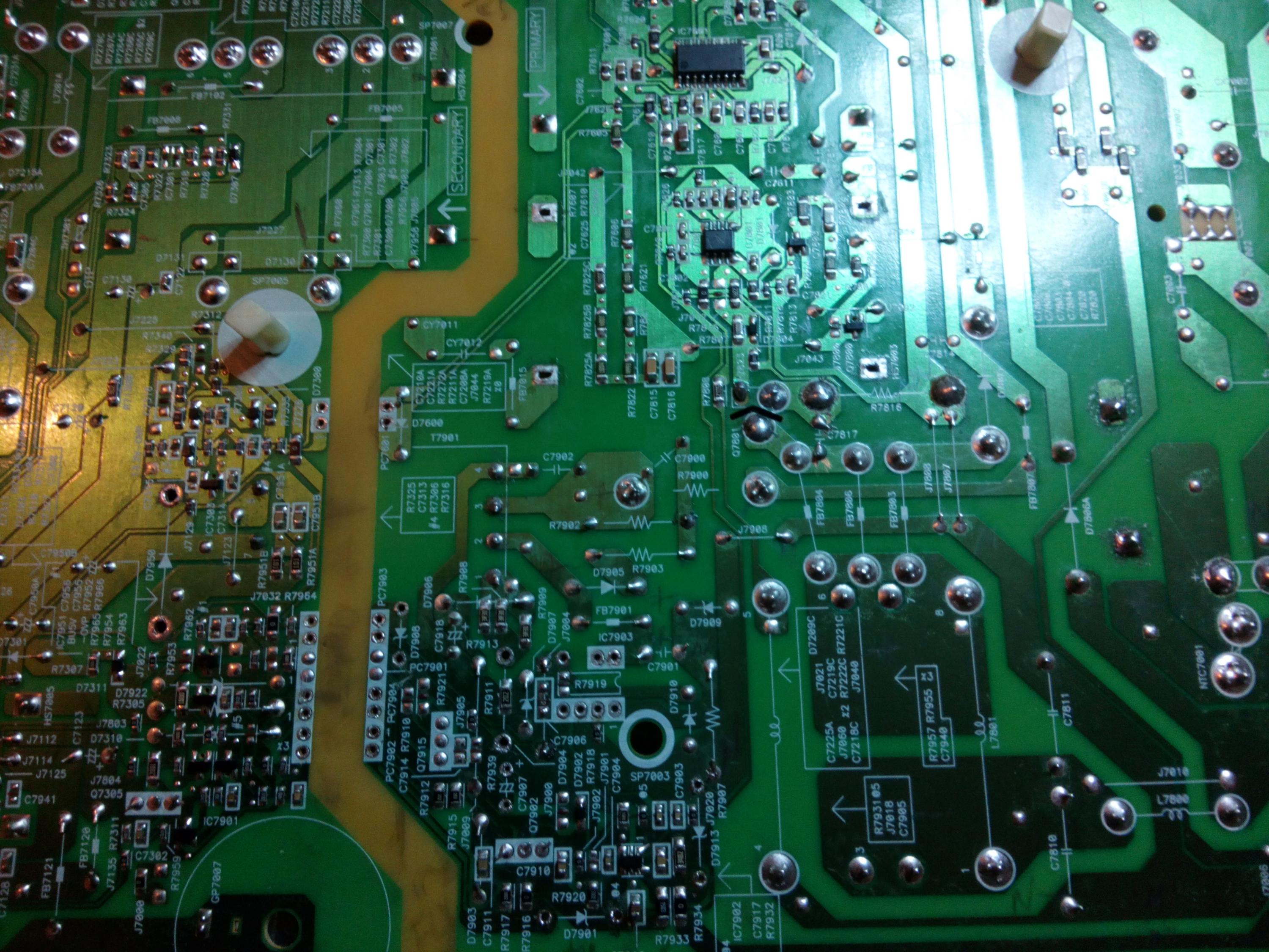

          the ic smps switch is the 7903, isn't it?

            The standby smps ic is IC7903 (your picture is not clear and out of focus)

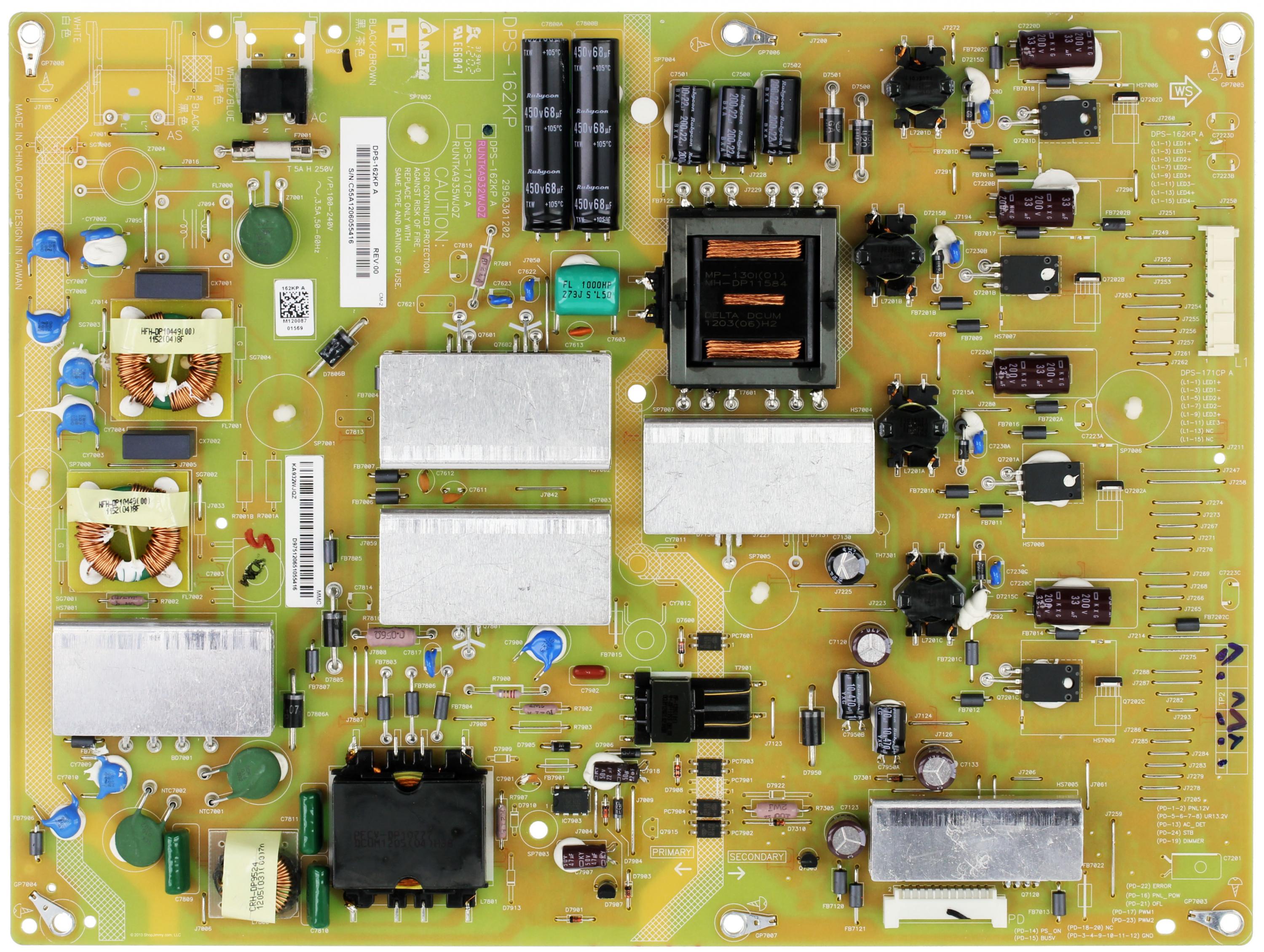

              here the images of a member another model but the same board more or less

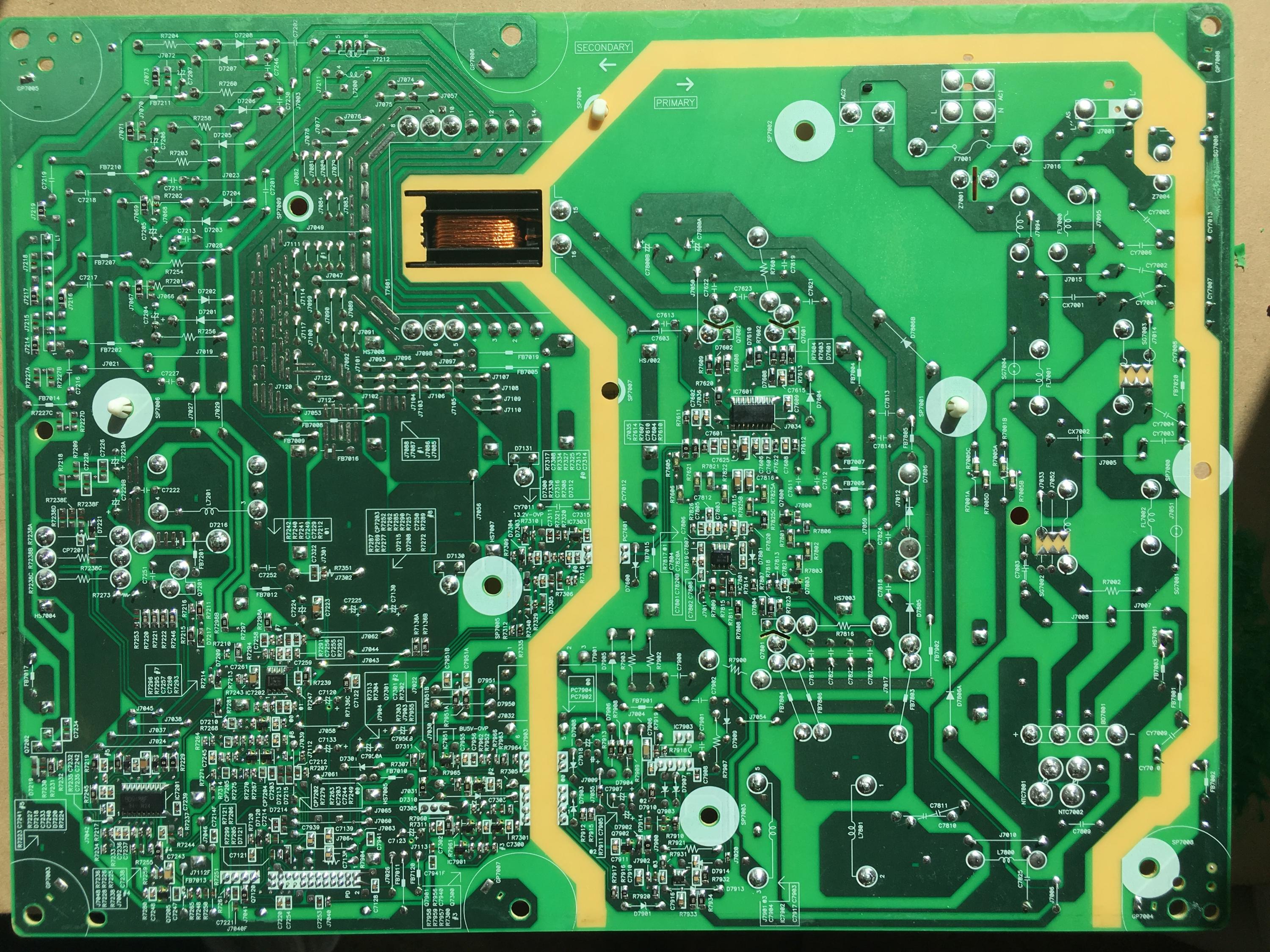

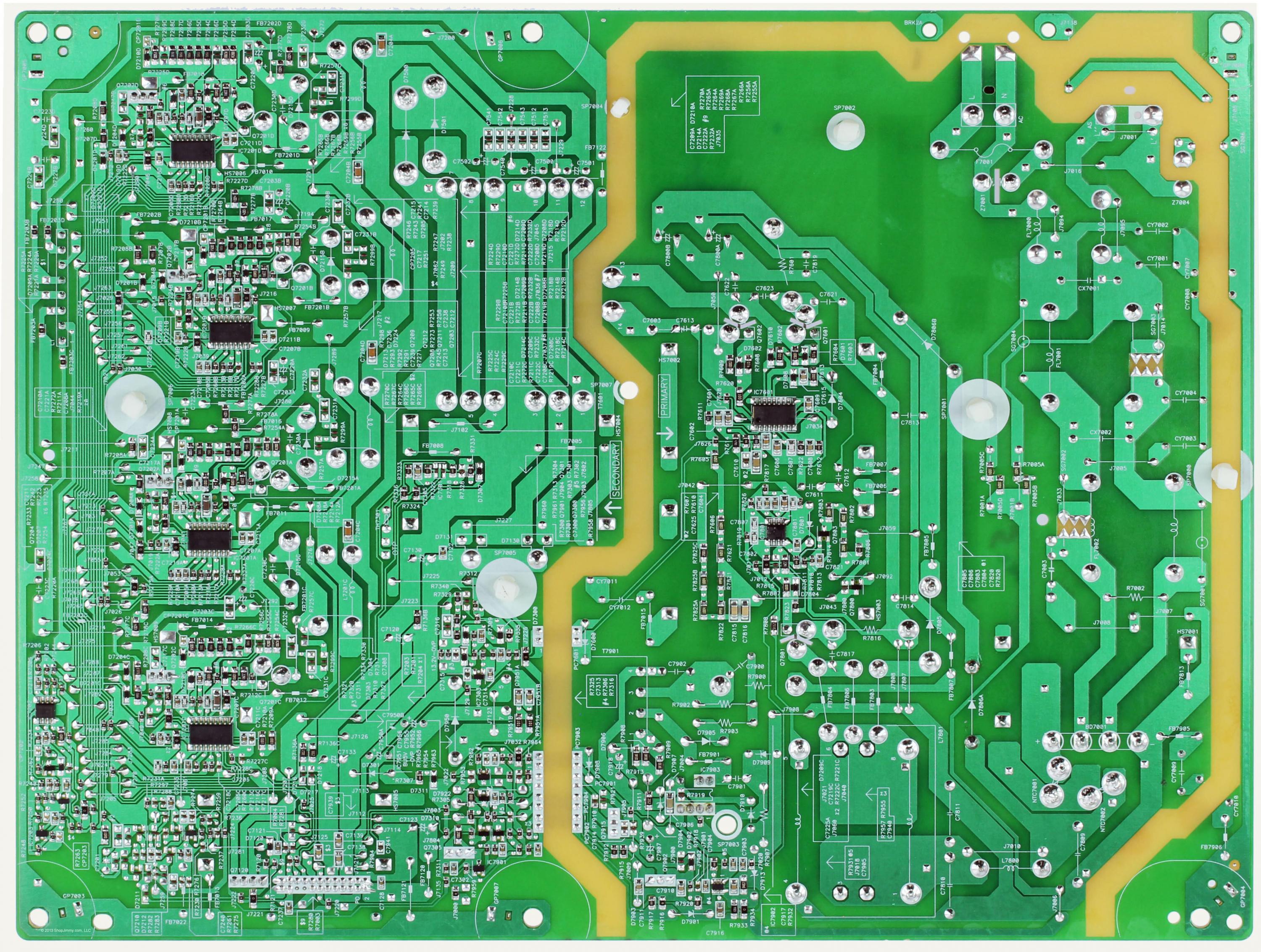

                Here are pictures of both sides of the board, courtesy Shopjimmy usa

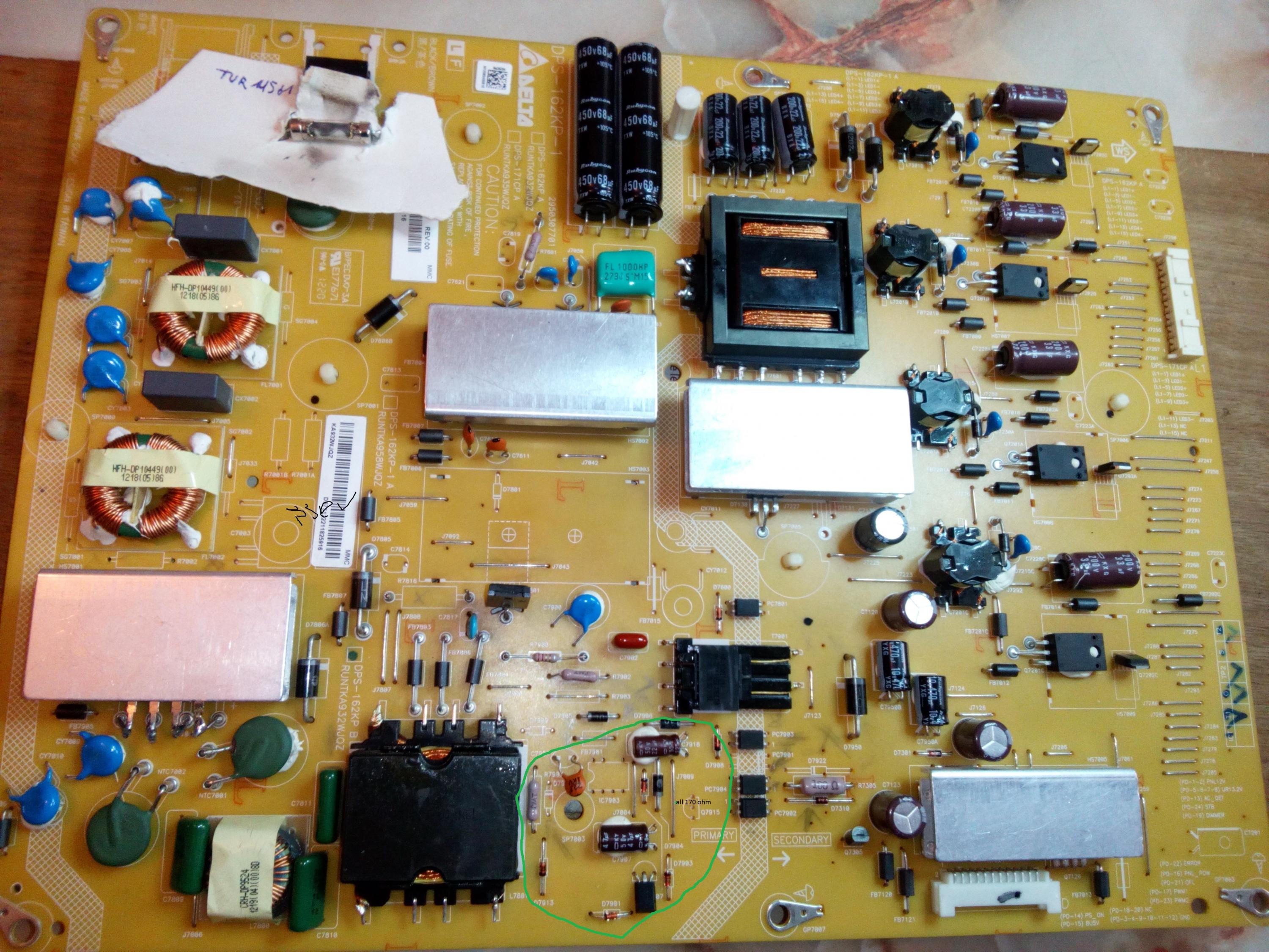

                  hi, with a little delay here I tested last night with everything reassembled except r7002. still the same nothing no t7901 output no stby5v voltage.
                  by the way a few days ago I measured or it is twisted in green at the level of the ic 7903 side above the card and I had the voltage which made the yoyo between the t7901 pin 2 and on the diode d7905 followed by c7901 after c ' was normal on the other components and 15 v in below the transform the 2 cap and diodes, it was just before deciding to remove this diode to see and ic 7903.
                  now I say to myself either a component in this area or the IC 7903 which unlocks or transform it into a short circuit I told myself from the beginning.
                    I don't understand? twisted in green? yoyo?

                      circled in green, around the ic smps and yoyo I don't know how to say in English it is the number which dijoncti which goes up then goes down then goes up, that's it
